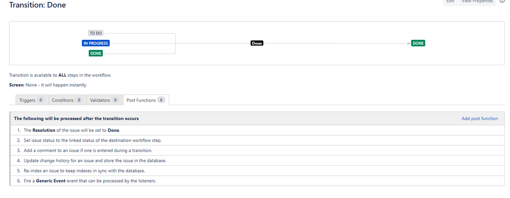

Hi Jack - sorry. I actually took a look at the workflow and it looks as though this is how it is set up OOTB. What am I missing?
Stefanie Sullivan
October 1, 2019
@Jack Nolddor _Sweet Bananas_  Sorry - spoke too soon. I took a look at the OOTB workflow and it appears to be setup correctly. What am I missing?
October 1, 2019
Could you confirm that this is the workflow your issue is using and if it is a draft or is already published?
You configuration seems OK to me.
Regards
Stefanie Sullivan
October 1, 2019
@Jack Nolddor _Sweet Bananas_  when I view the original workflow that is what I see. I will edit, click publish and see what happens. will this update existing jiras?
October 1, 2019
By publishing your workflow, you will change (if it was a draft) the behaviour of existing issues when transition from one status to another.
Any data ( I mean, data stored on fields) won't be modified. Note that unresolved issues will still unresolved after that but new issues will get automatically resolved after transition to the Done status, supposing all works correctly.
For old unresolved issues, I suggest you to bulk transition to the Done status again, after checking that this transition automatically resolves the issue.
Regards
