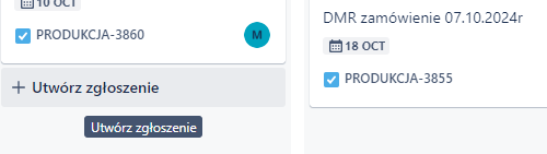

Hi! I have several boards in Jira but one is not working. If I add a new order using the blue button at the top, the order is "invisible". Zrzut ekranu 2024-10-08 164524.png
Nobody sees him. I have to add an order by scrolling down and at the end of the table "add order".
Do you know how to fix this error?

After adding a request using the blue button, it receives the message “In order for the notification to be visible, it must be in accordance with the project and filrt and have a status assigned to the board.”
And unfortunately, it is not visible. It appears in “notifications”

By using the create button (blue), is the ticket created in the project that the board is on and is in incorporated in the the filter used on the board.
The create button is a global option that enables you to create an issue in any project your have access to and are able to create tickets in.
By pressing this button, you need to check if the right project and correc t issue type is selected.

We choose the appropriate submission type and design. Nevertheless, it is still not visible. I checked if we have any filter and nothing. I checked if we have any automation and nothing. I checked each submission type (if it works on any) and also nothing. Do you know what it could be?

So the issue you are creating in a task in project PRODUKCJA
It is visible in the issue view, when filtering on the project.
Can you show the workflow, board configuration and the filter used for the board?

When you create the new ticket/order using the blue button, do you get a notification that the ticket has been created? If so, can you access the ticket, even if it doesn't show in the board? I wonder if there is a filter that prevents the ticket from being seen.

Hi, thank you for your reply. I apologize in advance for errors but I am assisted by google translate. I get a notification like this (translated from Polish):
We do not have any filrts. We use at a very basic level this opragromation. We add submissions in the office and the warehouse then switches statuses.
In addition, our new submission is not in the board but falls into “submissions” .

When you create the Jira ticket, what status does it have? Has that status been assigned to any of those columns? Thanks!

A status of “ to do” is created and such status is available in this column.
