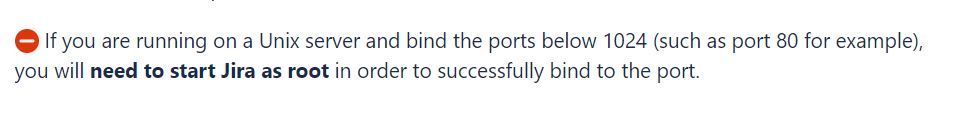

Below is screenshot of that line, in that article, which says running jira as root user

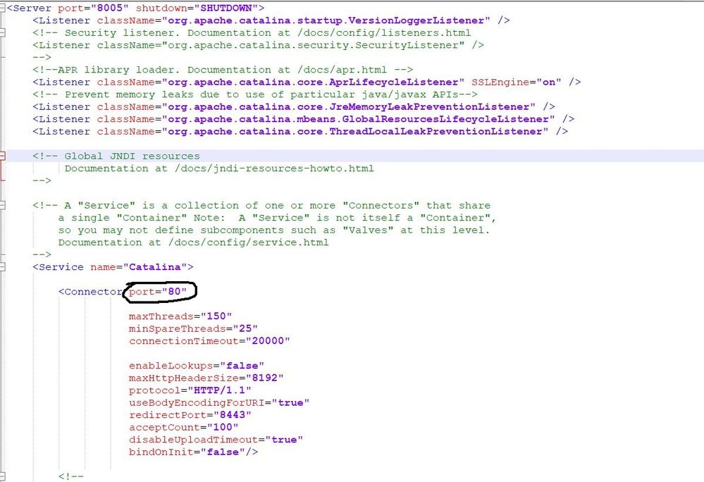

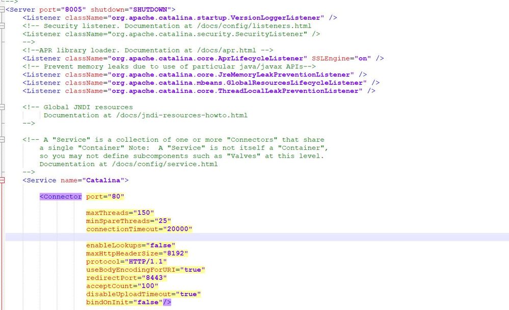

Attaching here with server.xml file screenshot after changing port from 8080 to 80

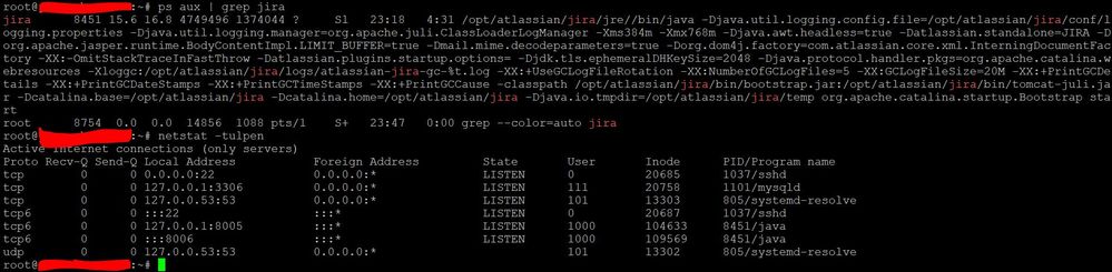

Also attaching result of running below command through putty
netstat -ntlp | grep LISTEN
(before changing port in server.xml)
(After changing port in server.xml from 8080 to 80)
@mdesaiThe question is did you change port in the server.xml you said you change it earlier. If the port is below 1024, then you will need to start jira with root user why? because port < 1024 are already used and grouped over the internet and the root user will enforce the bind port 80 even though it is widely used over the internet. But since you have change the port and remember, check all port by using the netstat -tulpen, to see all port in use, and choose port greater that 1024 so that you will not need to start jira with the user root. Further more, you should check port, by typing below on Ubuntu terminal below commands to check whether java is running on this port you have changed. To identify the java process id, first type
ps aux | grep jira " to get the process id aka PID followed by the below "netstat - tulpen "to see the TCP port java process is running on

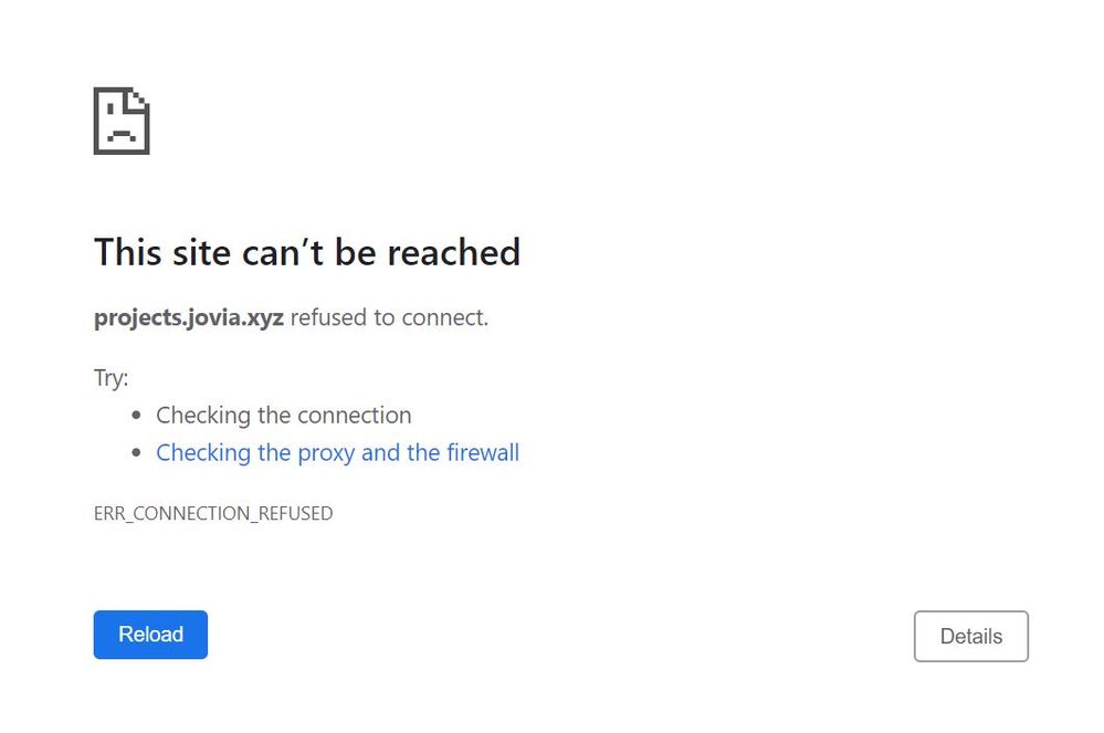

here is what I am doing now step by step,
Step-1

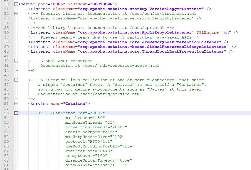

I changed my server.xml file in /opt/atlassian/jira/conf directory and manually changed <Connector > port from 8080 to 80 and here is the resulting server.xml file
Step 2

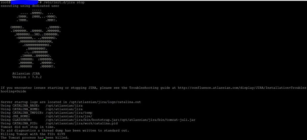

After that to restart jira service I ran below command to stop jira service
/etc/init.d/jira stop
Step 3

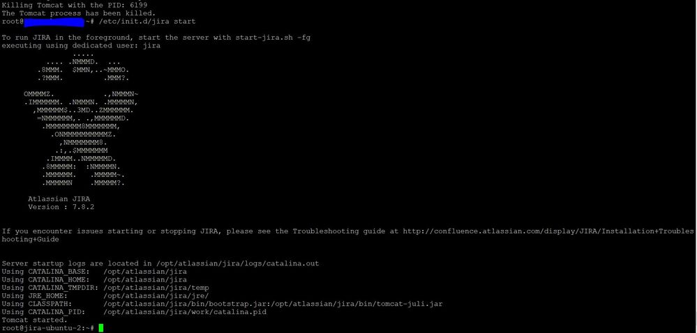

Then to start jira back again I ran below command
/etc/init.d/jira start
after that I am checking the url in browser but it displays below error

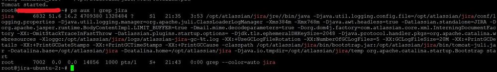

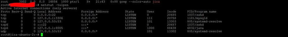

As explained by you, I am running below commands after this to check which port java process is using
ps aux | grep jira
Step 5
I ran below command right after that
Based on this can you tell me where am I doing wrong? In last screenshot, why java service is running on port 8005?

@mdesai As i have mentioned, please change port 80 to a port not mentioned when you type netstat -tulp for instance 8006. That java process running at port 8005 is for the whole Jira server, now the port 80 is for Tomcat server connector which is embedded in JIRA, for JIRA to run. And to make port 80 work you need to run as root to force bind port 80.
So please change port 80 to 8006 and we will be happy as long there is no fire wall blocking TCP connect at 8006 :)

Here is netstat -tulpen result
But this still does not solve my problem. The reason why I wanted to change my port to 80 was to access jira url without any port. Currently I am accessing my application using below url

I changed my port number from 80 to 8006 in <connector> tag in server.xml file and it is working fine now. Here is my server.xml file.

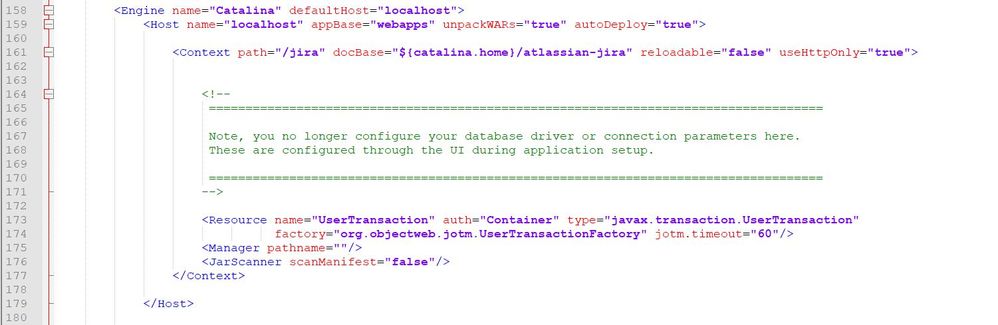

In the the server.xml you need to change the context path look for this line
Current
<Context path="/jira" docBase="${catalina.home}/atlassian-jira" reloadable="false" useHttpOnly=true >
After change
<Context path="" docBase="${catalina.home}/atlassian-jira" reloadable="false" useHttpOnly=true>in the /etc/nginx/conf.d/default.conf remove jira in the server block so you will have the below

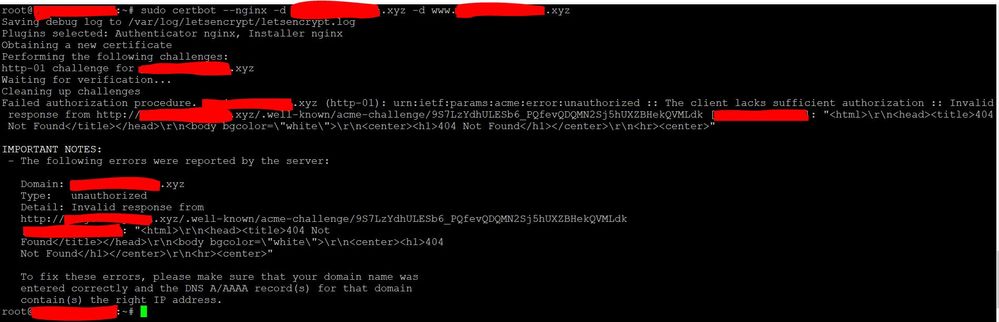

I guess since I am using nginx as reverse proxy server, the acme challenge is failing while creating and installing certificate using below command
sudo certbot --nginx -d [hostname].xyz -d www.[hostname].xyz
Below url is kind of example as to what is happening more or less ( our nginx is reverse proxy server)
https://community.letsencrypt.org/t/the-client-lacks-sufficient-authorization-404/5309
Can you please give me proper config changes in such a way that it will allow acme challenge to pass. The url it is trying to reach is as below
http://[hostname].xyz/.well-known/acme-challenge/RUGLFcgi4PvP63zu-gt5_kf_aG7_Pqax1yNK7UdfVtk
If I put a simple html file in above location then I can not access it in browser. it gives me 404.
http://[hostname].xyz/.well-known/acme-challenge/abc.html
I created /.well-known/acme-challenge/abc.html in /var/atlassian/application-data/jira/ folder and also in /var/www/html/ folders but I could not access abc.html using below url
So I guess we have to do some changes in config so that it allows access to
http://[hostname].xyz/.well-known/acme-challenge/*
Let me know your thoughts.
M
We are almost done, Regarding 1 point Before we continue with further configuration of nginx, let us fix problem with generating certificate using cerbort.
When you ping your domain by typing
ping domain_name /On the terminal
Which IP address do you obtain? and make sure you are typing the correct domain name,
Now the "error" say make sure we are typing the domain correctly and the DNS A/AAAA records for the domain contain the right IP
This means A/AAAA records are IPV4/IPV6 addresses; the IP address you have obtained from ping is it the same as the IP address in the DNS ZONE
check the domain manager make sure they are the same, i suppose it should be A record IPv4(address)
You can also check cat /etc/resolv.conf to see the Domain name and IP adress and the A record(Domain's IP) is the same as host IP address
change default.conf to
server {
listen 80 default_server;
listen [::]:80 default_server;
root /var/www/html;
server_name [hostname].xyz www.[hostname].xyz;
After verifying this then try to regenerate using
and check whether cerbort works later we will modify default.conf and nginx.conf to suit our needs.

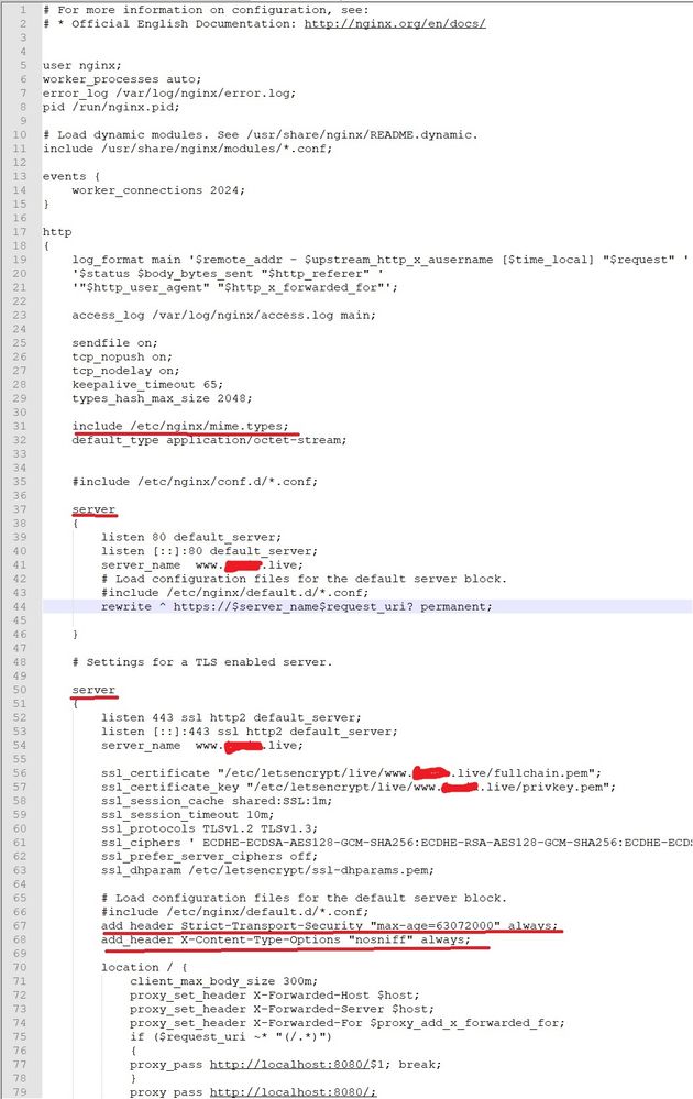

Hi @Moses Thomas ,
Thanks for clarifying things.
Since I was kind of in hurry, here is what I tried and it worked
https://certbot.eff.org/lets-encrypt/ubuntubionic-nginx
I followed all steps mentioned in default tab and it worked and
Now I have successfully installed certificate and I can access jira as
(P.S. i have changed .xyz to .live)

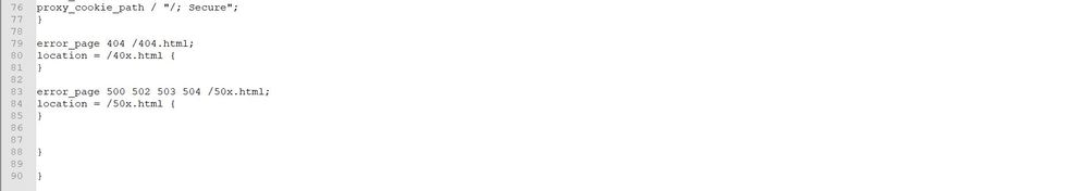

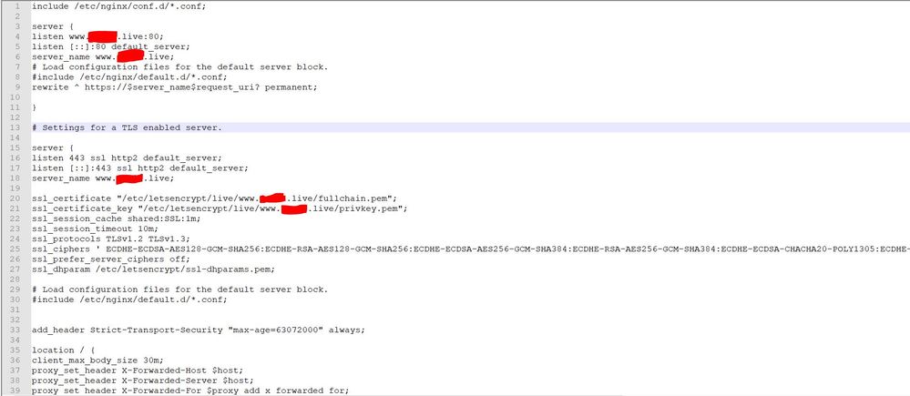

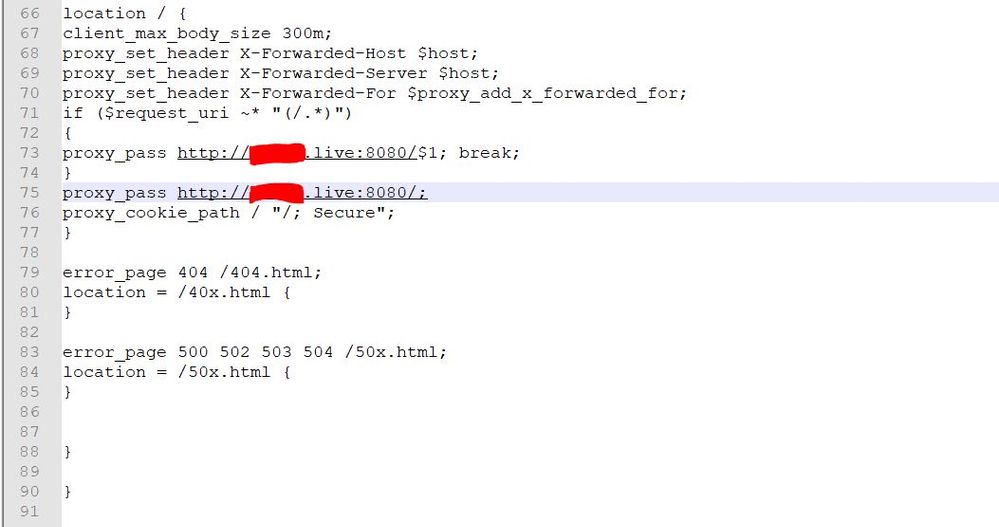

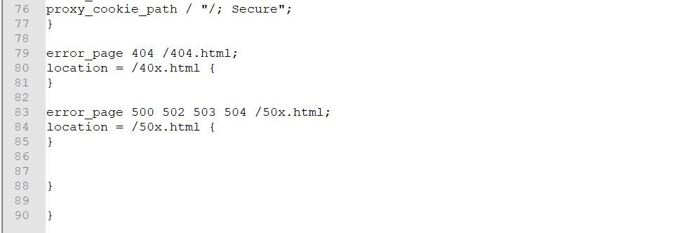

Here is how my /etc/nginx/conf.d/default.config file looks now
these changes in nginx config file are done by certbot only.
querries

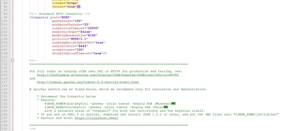

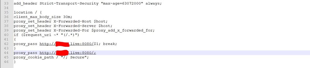

1. what changes do I need to do in jira server.xml or in any other config file to make compatible for https?

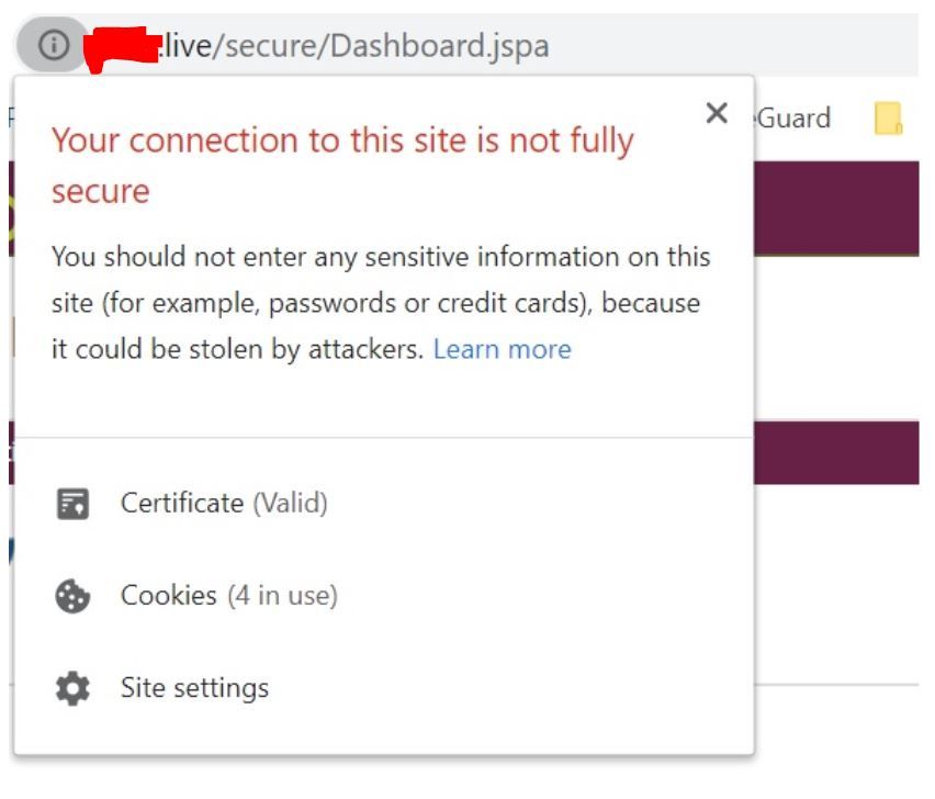

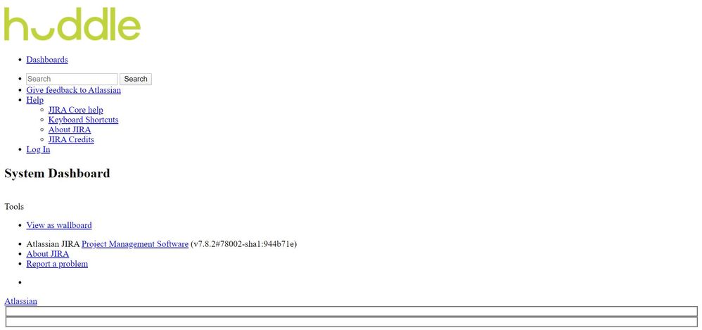

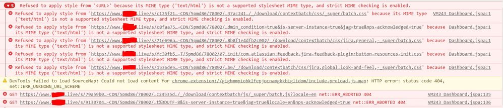

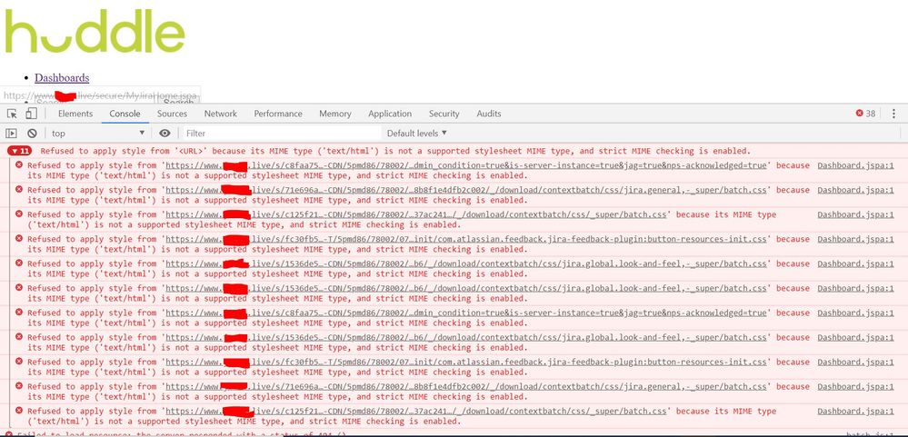

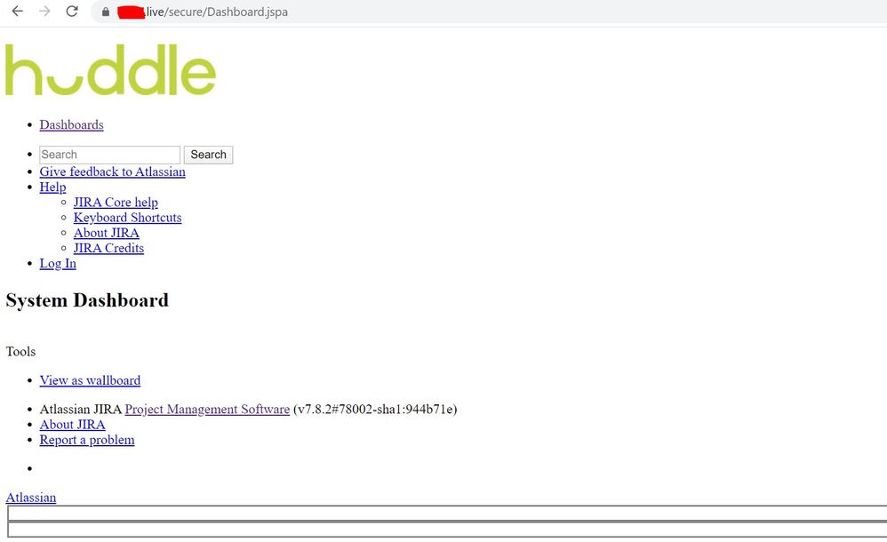

2. On home page I see this error instead of https lock icon
3. If I log in then on some pages the error in point 2 goes away and it displays lock icon.
4. some links are giving me 404 after loggin in (e.g. if I click on issue then it gives 404)
http://[myhostname].live/browse/INT-6
I also don't know why those urls are still http
5. images are loading using http hence not loading
I guess these all are related to jira config for https.
Please guide me on this.
M

Finnaly, i have attached to files in form of code just create jira.conf and replace nginx.conf
Follow carefully.
1.Copy default.conf and paste it somewhere on a note pad
2. Stop jira and nginx server.
3. Remove default.conf or move it to /root just in case later to be deleted.
4. replace nginx.conf with the file i have attached.
5. change server_name, (ssl_certificate,ssl_certificate_key, ssl_dhparam) paths to be the same as default.conf i ask to copy some where safe.
Restart nginx, restart JIRA. You should be alrite.

location / {
client_max_body_size 300m;
proxy_set_header X-Forwarded-Host $host;
proxy_set_header X-Forwarded-Server $host;
proxy_set_header X-Forwarded-For $proxy_add_x_forwarded_for;
if ($request_uri ~* "(/.*)")
proxy_pass http://localhost:8080$1; break;
proxy_pass http://localhost:8080;
proxy_cookie_path / "/; Secure";
error_page 404 /404.html;
location = /40x.html {
error_page 500 502 503 504 /50x.html;
location = /50x.html {
Mo

Here is my /etc/nginx/conf.d/jira.conf file
Here is my /etc/nginx/nginx.conf file

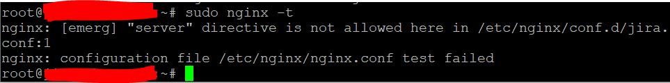

After doing these changes I am not able to restart nginx. if I run the command
sudo nginx -t
it gives below output
P.S. I have removed /etc/nginx/conf.d/default.conf file and now inside /etc/nginx/conf.d directory, there is just one file jira.conf

@mdesai Sorry my bad i have updated the nginx.conf lots where missing when i modified/ copied. Check it again
nginx -t && nginx -s reload
restar nginx, I hope it will work this time.

The error now is better :) the user "nginx" in the nginx.conf don't exist
just create it with the user add command in Linux and then check again
useradd nginx
ok. I created the user. so that error is gone but new one is coming up now as below

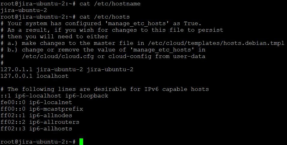

and please show me what you have in cat /etc/hostname and cat /etc/hosts

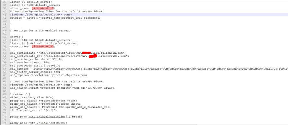

@Moses Thomas ohh ok, my bad. I thought I am supposed to do below changes
6. change server_name, (ssl_certificate,ssl_certificate_key, ssl_dhparam) paths to be the same as default.conf i ask to copy some where safe.
7. Lastly change listen, server_name, proxy_pass to be the same as in the default .conf.
in jira.conf and nginx.conf files. Sorry i misunderstood.
Here is my /etc/nginx/nginx.conf file now (copied your nginx.conf file only )
The only changes I have done in your nginx.conf file are ssl_certificate, ssl_certificate_key, ssl_dhparam which you can see above on line 53,54 and 60
The test has been successful now.
Here is output of cat /etc/hostname and cat /etc/hosts
Also, I am getting below issue in frontend
it seems like css files are not loading.
P.S. I have also changed the base url from backend to be https://www.[myhostnamr].live/
-M

Your server_name is jira-ubuntu-2, so change server_name in nginx.conf and comment out
#include /etc/nginx/conf.d/*.conf;
and do the test again.
Finally restart JIRA server the restart nginx
ok. got it. but even after those changes there is still something wrong.
sudo nginx -t && nginx -s reload runs successfully but when I visit the url
then it gives me 404 not found
and here is my jira.conf file now. Note that the server_name in jira.conf is
www.[hostname].live which it taken from my previous default.conf file.
Here is my nginx.conf file now. I have highlighted server_name variable value in it.
-M

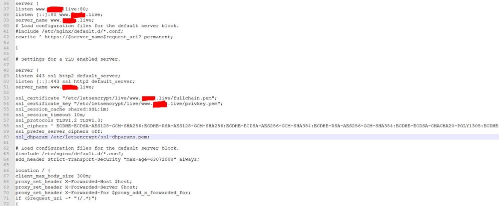

yes I forgot the include line to comment out. I did that and removed jir.conf file and restarted jira and nginx but it is still not working.
if I type url
https://www.[myhostname].live/
in chrome then it takes me to
https://jira-ubuntu-2/startup.jsp?returnTo=%2Fdefault.jsp
here is nginx.conf
-M
In server_name change to domain name which is your case
Try please and give feed back ASAP lets finish this issue today !
really appreciate that.
I changed the server_name to www.[hostname].live
it worked now. the only issue is css not loading
-M

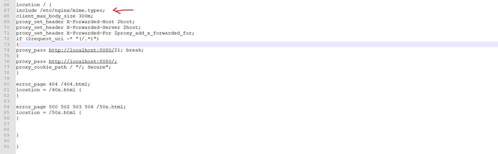

@mdesai I once had this problem before but i don't recall how i solve it hmm
* Take include /etc/nginx/mime.types; back to where it was and then reorder these
to have the below and then try
default_type application/octet-stream;
* If it does not work, check firewall and appamour make sure they are not block anything (you may disable temporarily and try)
* Clear web browser( so we can rule out cache issue)
* Press F12 on the web browser and on the console check errors found.
* Show also /var/log/nginx/error.log may be we could find some information there
* You may try to reboot the server ( "most likely useless)
I tried all suggestions but none of them worked. still the same issue
Here is F12 console errors:
and here are the error.log details:

After reading the X-Content-Type-Options it seem we need to add point2 in the server block in nginx.conf change back to
Point1
add_header Strict-Transport-Security "max-age=63072000" always;
Point 2
add_header X-Content-Type-Options "nosniff" always;
And verify and restart nginx, and check browser with firefox, chrome ,opera
Still isn't working. same error in all browsers
P.S. there are 2 server blocks and I have added point 2 on second server block.
Correct me if I am doing something wrong.
-M
