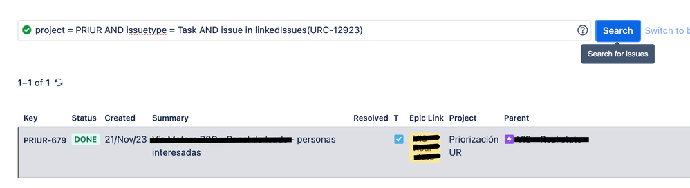

The function works correctly in the filters section:
but when I run the same JQL in the automation test it shows "0 issues found":
Could someone help me find out where the error is?
Thanks!

Hi @German Dobrilovich
What is the scope of your rule: project, global, or multiple-projects?
And if it is project scope, in which project is your rule stored?
I hypothesize your rule is project-scope and not in the PRIUR project.  Thus the rule only has visibility to issues in the rule's project, and so the JQL returns no issues when you try to validate it.
When a rule needs to access issues in all (or multiple projects), create the rule at a global scope and adjust the rule details accordingly.  Only a Jira Site Admin (or Org Admin) can create such rules, as they can have a large impact on the site.  Please discuss this with your admin for more details.
