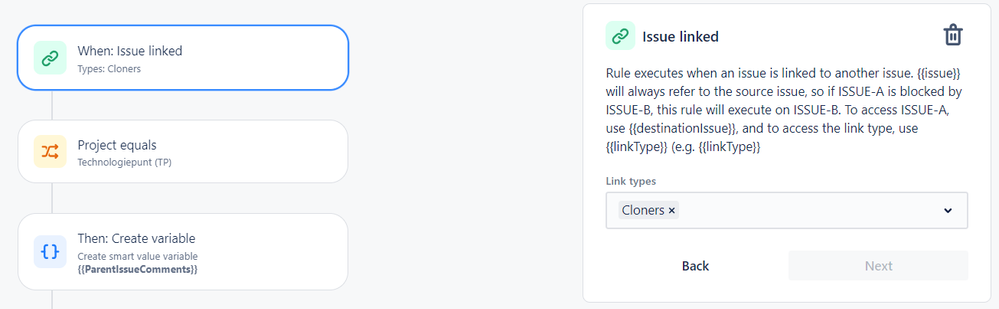

I have a trigger that starts on the cloning of an issue
When Issue linked (cloners)
the {{triggerIssue.key}} seems to be the master aswel as the {{Issue.key}}.
to paste a comment in the clone i need to get the most recently created issue from the branch I do assueme.
The Audit log provides me 2 issues for the trigger so if I can get these values in a var it would be possible to?
help is welcome.
Steven Vits
February 25, 2024
Reading the audit log provided me the info:
you can also access it via {{destinationIssue}}):

Steven Vits
February 22, 2024
I'm affraid this is not a possible approach in this case.
I do have a manual trigger that clones an issue to another project depending on a choice field given in a pop-up.
Due multiple choices the rule is getting to long for multiple additions, max 65 actions.
So thing is I'm trying to figure out how to copy the comments from master to clone in a global rule.
It seems to work but finetuning that only the latest clone will be provided with all the comments would be appropriate.
What I made was next:
the most recently created is giving next error:
Branch rule / related issues
Can't branch rule as it requires issues to have been previously created by this rule. More than likely you have not yet created an issue or the issue(s) were created in an another 'If' block or branch - these would then not be visible outside of that block/branch.
other option is commenting all possible cloned issues but wanted to cover that would not happen.

Steven Vits
February 22, 2024
You could be true in some cases @Walter Buggenhout
the first flow however is quite simple but the taken steps are repeated multiple times due of multiple possible projectchoices.
That is a buisiness driven choice I can not interfear with.
So I try to make it simpler making a manual action with choice field.
otherwise manual clone and manual move clone to and change status of issue.
I do not see at this point how to simplify that.
copying all comments of the master is the second rule but therefor I do want to select the new made clone instead of possible other clones.
Thank you for the given advice.
Steven Vits
February 25, 2024
