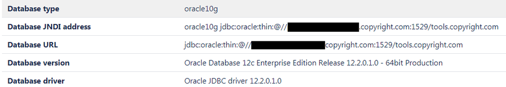

I just saw the notice regarding the release of Jira Server 8 and the new "Plan Your Upgrade" tool. I am currently running Jira Server 7.12.3 with an Oracle 12c R2 database, and I ran the tool to check for an upgrade to Jira 8.0.0.
Everything except step 1 looks good. In the pre-upgrade check, it tells me that I'm using an unsupported database. However, when I click the "learn more" link, I see that Jira 8 supports Oracle 12c R1. I have the correct JDBC driver installed as well.
All I can think of is the the check is looking in the "Database Type" field, which must list oracle10g (anything else throws an exception and Jira will not start).
Is this a bug in the planning tool? My system specs relating to database are listed in the attached image.
Always check the supported platforms page to make sure you are running a supported configuration. As you can see from the Jira 7.12 supported platforms page, you are not running a supported configuration. I expect this is what the tool is complaining about. Only 12c R1 is supported on Jira 7.12 and 8.0. It may work, but it would be best to run a supported platform.
Wow, thanks Dave. I assumed that if R1 was supported that R2 must be as well.
