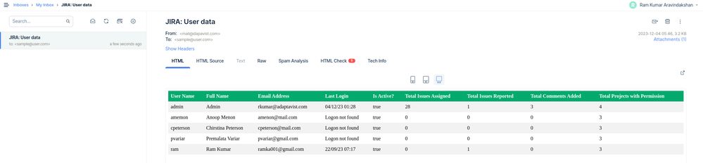

I tested with 5 projects and 5 users in the test case I used. Of the 5 users, only one has access to all 5 projects, i.e. the Admin user. The others have access to only 4 projects.
Below is a screenshot of the example output that you should receive via email:-
I hope this helps to solve your issue.
