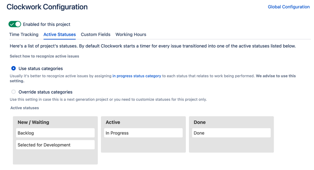

On the other hand, did you consider using third-party apps for time tracking?
I can recommend our Clockwork Automated Time Tracking & Timesheets Free app. It has a feature that allows users to track time automatically whenever the issue is on the "active" status. You can control which statuses are active. In that case, Clockwork would track time automatically without much involvement from the assignee.
There are more features that might be interesting for you, if this is something that you would like to try, contact us via our help center, and we can help you with the configuration that would fit your company use case.
