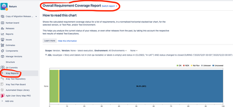

Hi Community,
I have the following jql for obtaining the overall requirement coverage: (think of it as obtaining overall requirement coverage via a jql :) Please see screenshot of X-ray requirement coverage)Screen Shot 2020-12-27 at 14.07.35.png
the jql works fine, with the exception that stories with linked issuetype = test execution  are also shown. However, I would like to get only those stories who were tested by issuetype=test

Hi Community,
Finally got the answer after thinking with a cool-mind :)
project = "XX" AND issuetype = Story AND "Requirement Status" != "UNCOVERED" AND status changed to closed during ("2020/11/01 00:00", "2020/12/1 00:00")
should do the trick of showing only those requirements, that have been covered by Tests
