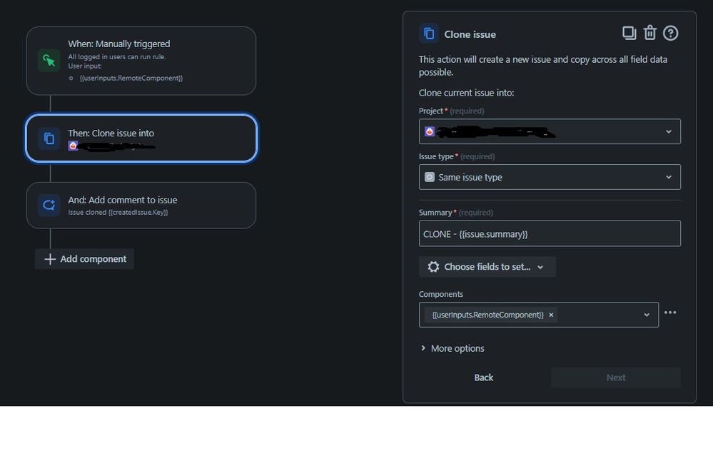

I'm not editing JSON directly. I'm just using the UI option to set a field in the clone issue action.
What I have at this point is super basic and literally just trying to add a user input smartvalue into the components field.

I have not edited the JSON, but here are the contents of the additional fields on the Clone Issue action.
    "update": {
      "labels": [
           "add": "cloned"
     "components": [
          "add": {
              {{userInputs.RemoteComponent}}

Sean Hagans April 12, 2024
For anyone replying, have you tried what I'm doing? Has anyone successfully used a userInput or general smart value as a value on components field?
I'm assuming by the way people are asking that this is something that you've seen work and know it should work, and thus the only way it wouldn't be working is if I'm doing something wrong, is that correct?
Sean Hagans April 12, 2024 edited
well I'm not doing any of that, I just added the components edit to the clone. Jira did the rest. Do I need to remove the JSON or something? I didn't write it or make it, I just looked at it by expanding that UI item at the bottom of the panel.
Also this is the 4th time I've made this same rule from scratch. It's literally as simple as I've put it here.
1. Select new rule
2. Set as Manual trigger - check box to ask for input field - set field name, add values, set smartvalue name
3. Add Clone issue - set target project - add the set component - add smartvalue of input field as value for set component
Done. That's it. No other actions on this, no editing of defaults, literally just those 3 things. Repeated 4 times with the same failures.

Remove the components selection from drop down.
In the JSON section, replace existing contents with below and retrigger the rule.
"update": {
"labels": [
"add": "cloned"
"components": [
"add": {
"name": "{{userInputs.RemoteComponent}}"
I'm not angry, I just want to make sure I don't confuse people into thinking that I'm doing something other than selecting the UI options. I am also legitimately asking if anyone replying has done this or is doing this with success. No one has said "it works for me, here's what I have that is working". So I want to make sure that answers are related to finding out what is non-standard about mine rather than asking me to try things without knowing if it should work out of the box.
Removing the component edit from the clone and replacing the auto-generated "additional fields" JSON with yours results in a 400.
Not sure if that's progress or not.

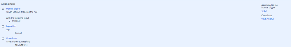

Kalyan Sattaluri
April 12, 2024
Hello @Sean Hagans
I have sucessfully tested your rule.
As you can see from my screenshot, my advanced JSON did not auto-populate with "components" object by itself.
One final try, delete everything in Advanced Section, redo the components drop down with your initial smart value, BUT, specifically choose the Issue Type..
hey that worked! Thanks!
I'm not sure why it's auto-populating on my side, but when I remove that manually and hit update, I get what you have there. I just recreated a new rule and it did the same thing.
Looks like the problem is that for whatever reason, my rule is auto-generating a JSON in additional fields when I add a component field edit and that is messing it up. Removing that makes it work.
Thanks for the help.
