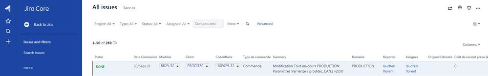

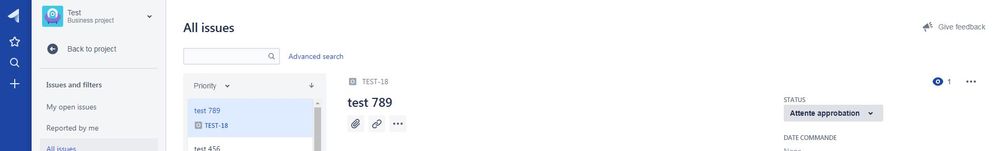

In my project I can't get the issues list screen by 'list' like from Jira screen->issues and filters.
I can get only 'detail' screen.
Anyway to have the same display system in project and Jira issues filters ?
Project, issues and filters

As of today, you need to click on the "Advanaced search" to get into the issue navigator, to get the option to switch between 'list' and 'detail' view.
I would think this was an oversight and they will probably add the "list" view even on the proect > Issues and Filters screen as well.
