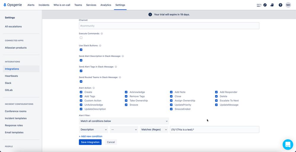

I'm having trouble filtering alerts that use the Slack integration. In this case I would only like alerts containing "This is a test" in their description field to use a Slack integration. Below is the filter I have applied to my Slack integration.
I've also checked and confirmed that alerts contain "This is a test" in the description field by going to  OpsGenie > Settings > Logs.

Hi @Issy Pearson ,
Maybe try filtering with regex using one of these values:
.*(This is a test).*
(?i).*(This is a test).*
The second would be case insensitive.
I typically use regex101 to validate if an expression will work.
Issy Pearson December 11, 2022
@Nick Haller Yep that works thank you! I shall definitely have to brush up on my regex.
