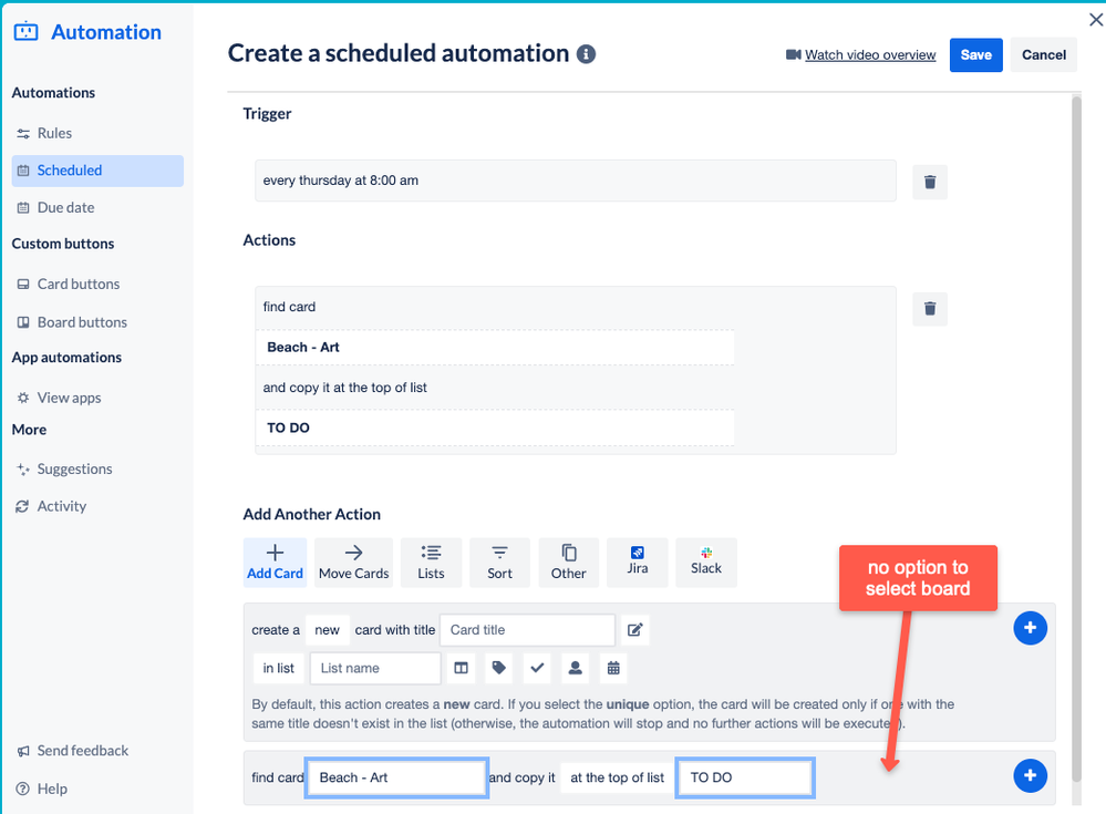

I asked this question in a different thread here, so I apologize in advance if it's redundant, but I wanted to add more detail.
Here's my issue:
How can I automate copying a specific card to multiple boards weekly?
For example:
I need to copy Card A from Board A to a list on Board B and Board C every Thursday at 8am.
Is this possible using the Repeats power-up or Automation with scheduling? I don't see an option to do so.
I was able to get close by creating an automation rule like this:
every Thursday at 8:00 am, find card "Beach - Art" and copy it at the top of list "TO DO"
The problem is that I don't see an option to specify which board to copy the card to. Perhaps this is the wrong method?
See screenshot below:
I understand there may be other work arounds such as creating card buttons to copy the card to the designated board OR creating an automation rules to move a card to another board based on selected criteria as suggested in this thread:
https://community.atlassian.com/t5/Trello-questions/Re-How-to-automatically-copying-a-card-and-its-content/qaq-p/2766402/comment-id/96897#M96897
But my use case is a bit different because I need a single card to be copied to multiple boards, not just one.
Thanks!

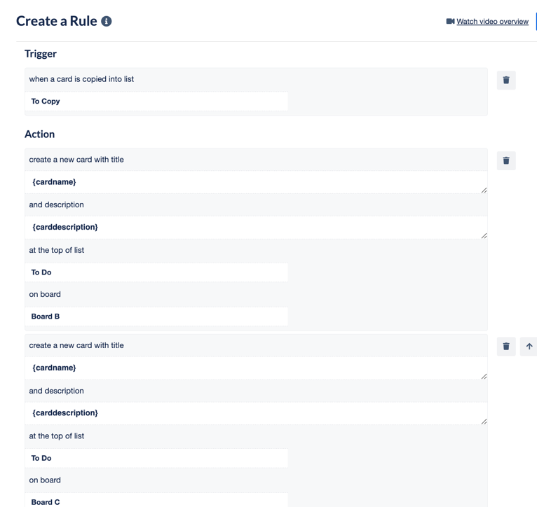

Hi Jesse,
What kind of information from the card are you trying to copy over? If this is copying a card to create new cards and retain their card title and description, then I may suggest creating a dedicated list to copy your card over. Similar to your automation rule like this:
every Thursday at 8:00 am, find card "Beach - Art" and copy it at the top of list "To Copy"
as this list is only used for this scheduled automation, I can then use a rule that triggers when a card is copied over to this list:
when a card is copied into list "To Copy", create a new card with title "{cardname}" and description "{carddescription}" at the top of list "To Do" on board "Board B", and create a new card with title "{cardname}" and description "{carddescription}" at the top of list "To Do" on board "Board C"
the rule looks like this:
You can add more things to copy over if you need a checklist, or members, or due dates.
I hope this helps, but let us know if you have any questions!
