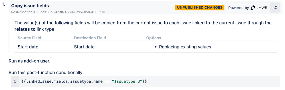

you need to add a Copy Issue Fields (JMWE App) post-function to your transition, with a configuration like this:
Of course, the source and destination fields will be "MoA Signed Date", and you'll have to update the issue type name in the conditional execution script:
{{linkedIssue.fields.issuetype.name == "Issuetype B"}}

Sorry, forgot the second condition on the linked issue's status, so the conditional execution script should be:
{{linkedIssue.fields.issuetype.name == "Issuetype B" and linkedIssue.fields.status.name == "Open"}}

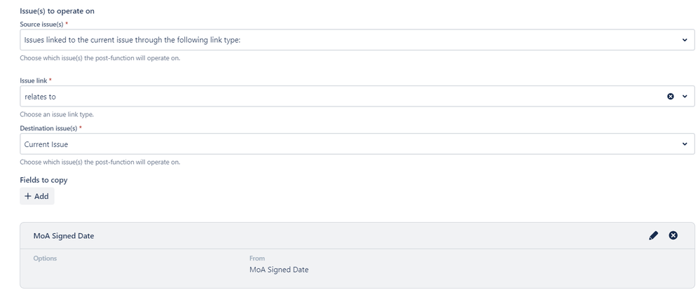

If you reverse the method:
When submitting status on Issuetype B, it will copy a customfield (MoA Signed Date) from Issuetype A to the Issuetype B that only has OPEN status.
then I need to configure it like this:
Current issue is Issuetype B
and for the Condition :
{{linkedIssue.fields.issuetype.name == "Issuetype A" and linkedIssue.fields.status.name == "Open"}}
am I right?
David Fischer
March 13, 2025
Not quite: you don't need a condition on the status of linkedIssue (Issuetype A). And you don't need a condition on the status of Issuetype B (the issue being transitioned) since you already know the source of the transition (if you created your transition from status Open)

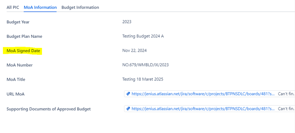

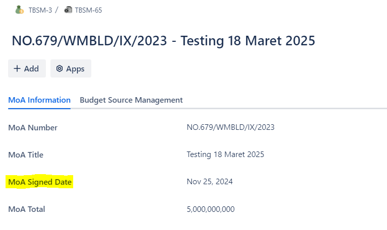

Hi @David Fischer ,
when I tried the query you gave me a few days ago,
it doesn't seem to work (but, it should work (?))
and when I check in the Post Function configuration, there is no error or warning notification.
and this is the MoA Signed Date of Issuetype A

and this is from Issuetype B (MoA Signed Date didnt changed)
Any suggestion?
David Fischer
March 20, 2025
Hi @RIZKY JTUASIKAL
did you trigger the transition on TBSM-65? Also, is the linked issue of type "MoA Project" and is its status "Open"?
You might want to go to the JMWE Logs page and temporarily set the log level to DEBUG, then trigger the transition and check in the logs that thee post function ran.
