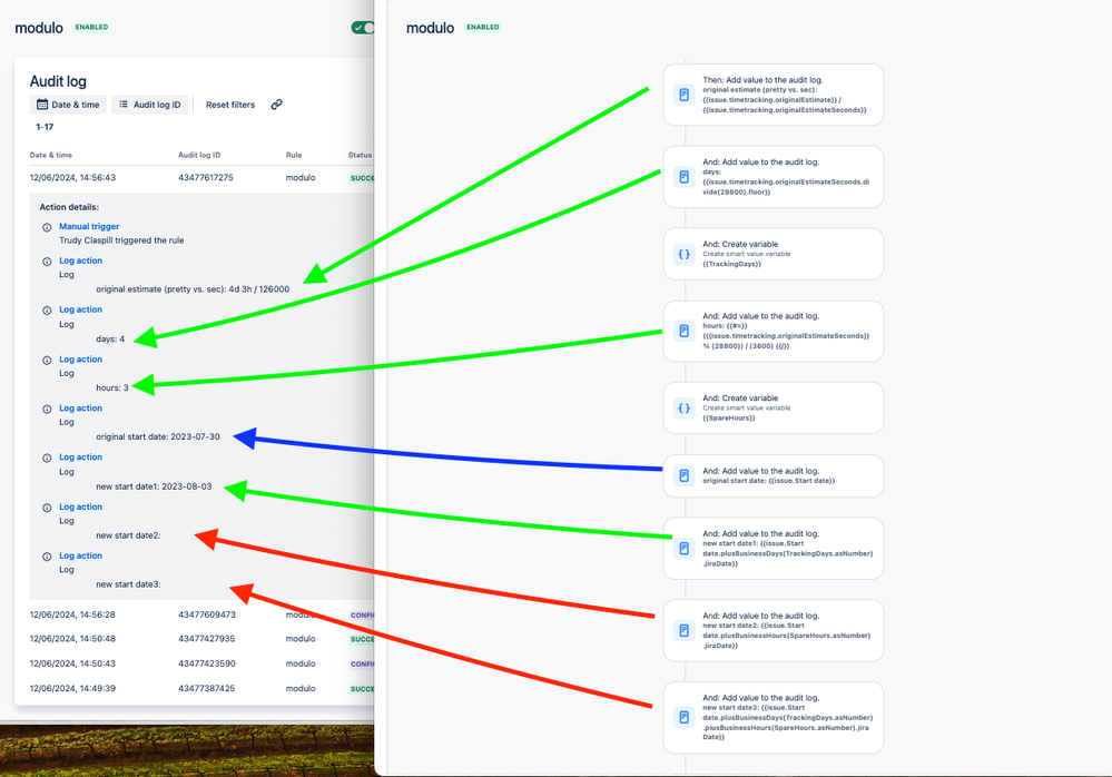

The first three log actions are logging the Original Estimate and the calculations for Days and Hours of that estimate. Those all work.
The blue arrow shows where I log the value of the date field that I want to modify.
The next green arrow logs where I added only the Days value to the date field. This works.
The two red arrows log where I tried to add the Days and Hours value, and just the Hours value, to the date field. Notice that both of these produce no result.
As for the floor and ceil functions, I'm not convinced that either of them work properly in this case. I tried both floor and ceil, and in both cases I got "4" as the result.

I produced the image above by have the rule's audit log open in one browser tab, and in another browser tab I was viewing the rule details. I just resized windows so I could look at both side by side.
If you are referring to the "Log action" messages in the audit log, those are produced by adding the Log action components to the rule.
