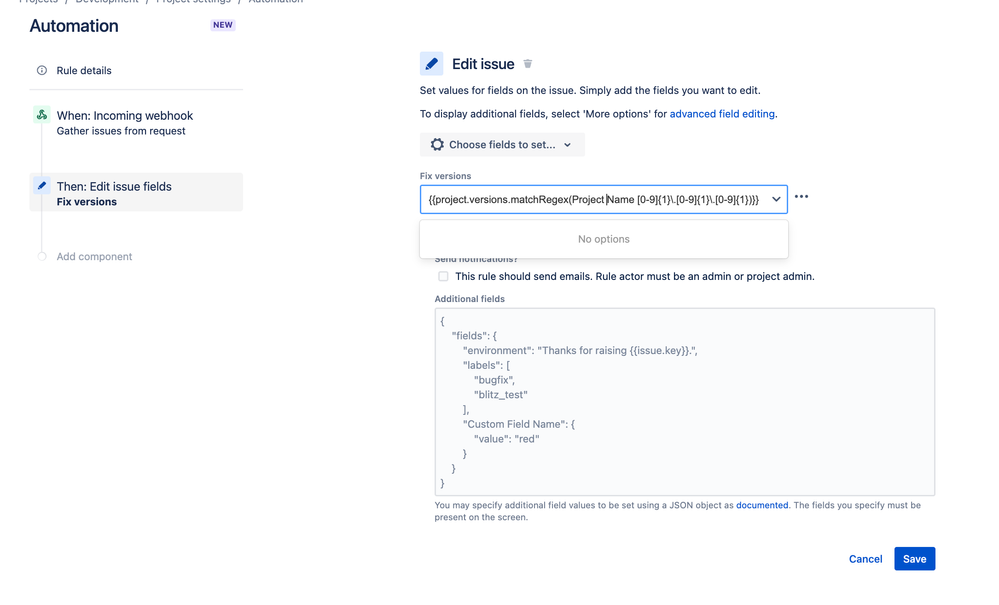

We have a project where versions are named based on a name scheme that makes them predictable. Like "PROJECT NAME 0.0.1"
I would like to create a rule that edits an issue and assigns a specific version based on a regular expression.
Is it possbile to use a regular expression in the fixVersion field to choose a specific version based on its name?
Please see attached screenshot, where I tried to add some "pseudocode" to the fixVersions field to give an idea of how I envision the regular expression to be used.

4 answers

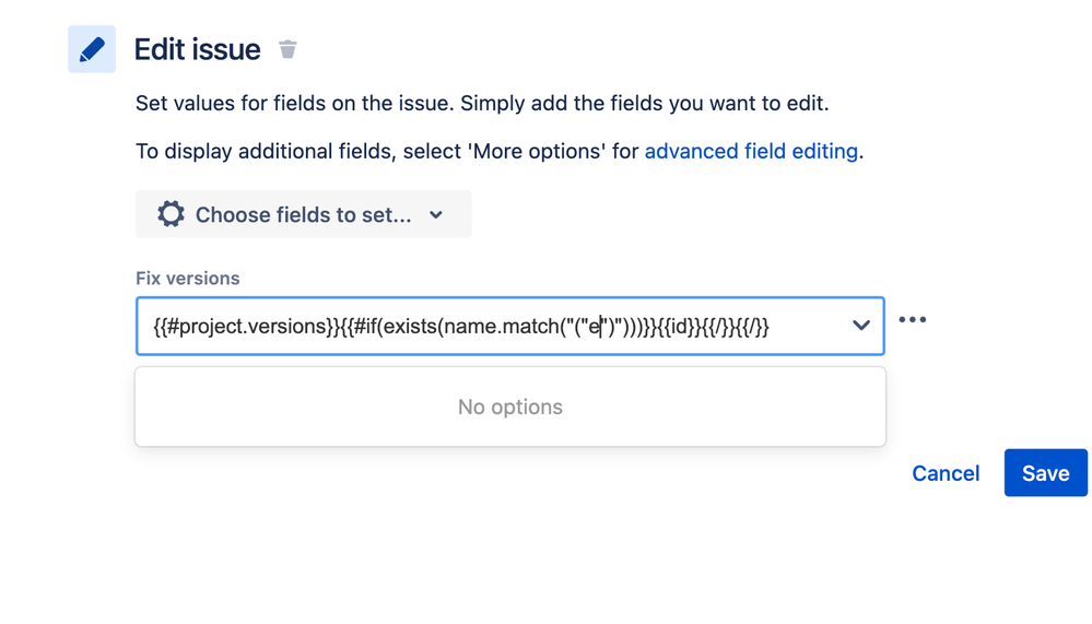

Daniel Graungaard September 3, 2022 edited
Hi @Bill Sheboy
Sorry for the late reply.
I tried you solution a couple of times now, and when I copy it into the field in Jira the dropdown just say "No options" and there is nothing I can choose. (see screenshot below)
I tried putting the regex in as many formats as I could think of. But I just cannot seem to find the format that the dropdown will accept.
Can you point me in the right direction?
