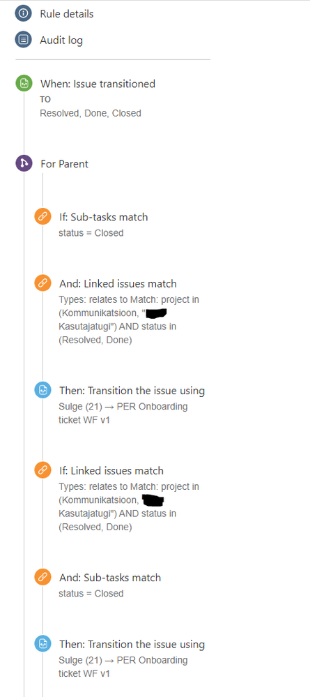

I have project where i have main issue. When user click IN PROGRESS then there is one sub-task and 2 another ticket into another Jira project. Relates to issue link between main ticket and another project tickets.
Now when Relates to and sub-task status is Closed, how i should write automation what close main ticket also?
WHEN Issue transitioned to Closed
IF Issue Type equals Sub-task
For Parent
IF Sub-task match status = closed
Then Transition the issue to Closed
but how i should add relates to issues into this ?

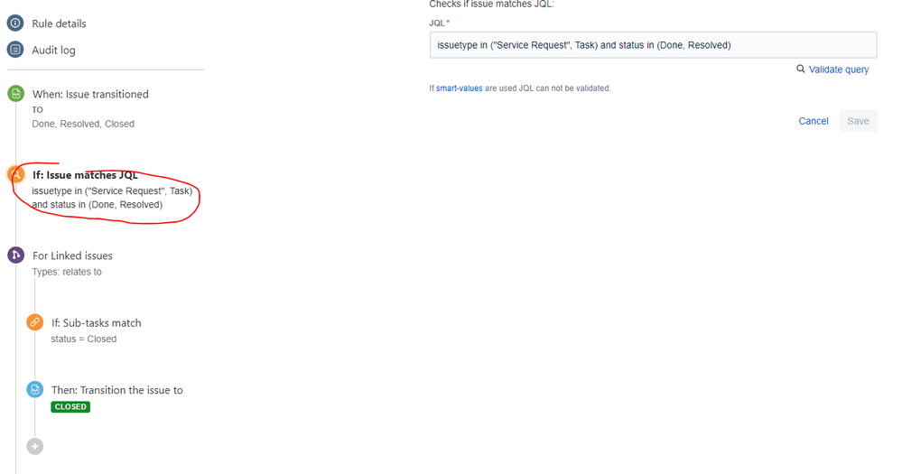

Urmo Luts April 29, 2022
Hi
Seems to be that right now is working when last closing issue is sub-task. But when another issue from Project Kommunikatsioon or Kasutajatugi, then it does not work.
I have sub-task + two another jira project and they have different closing status (Done, Resolved, Closed).
Yes i know there is today too much status what do same thing but i'm working to close up this old solution.

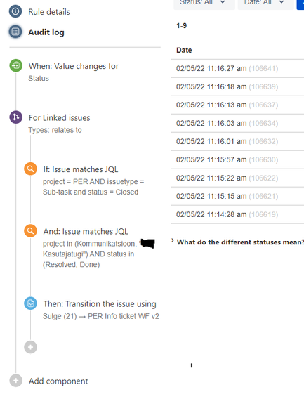

Urmo Luts May 2, 2022
Hi @Stefan Salzl
I made one long automation into two. Seems to be that sub-task close work fine but this when sub-task's are closed but relates to tickets are opened but after last relatest tickets closed it does not close.

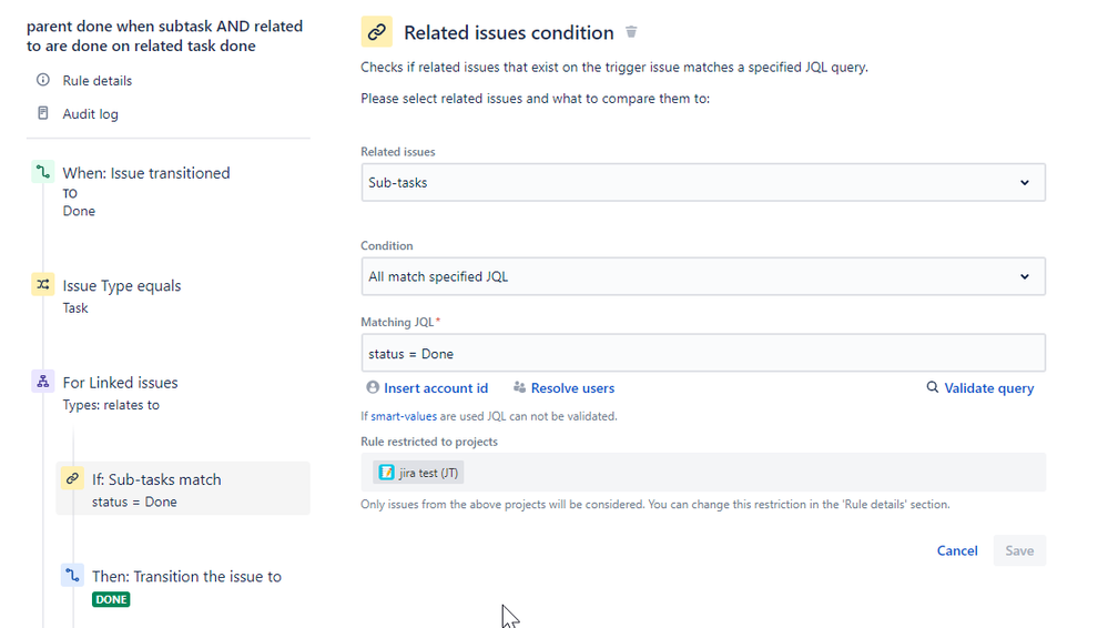

Hi @Urmo Luts
I tried to reproduce what I got from your description:
Rule 1 - trigger is transition from linked issue (relates to) to done
Rule 2 - triggers when subtask is transitioned to done (then checks if other subtasks exist and all are done and if related issue exists and is done)
This is the most simple version of the described requirement. Issue types and status needs to be set according to your configuration.

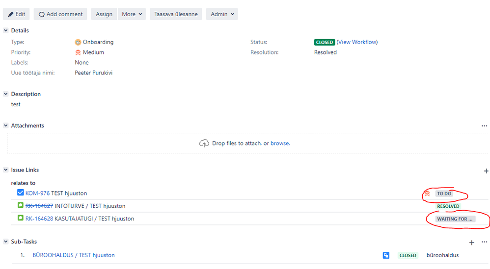

Urmo Luts May 3, 2022
Hi
Seems to be that it allmost works but i think i had made some error into.
Right now is one relates to is closed/resolved/done, then parent issue is closed also.
Seems to be that i have done something wrong...

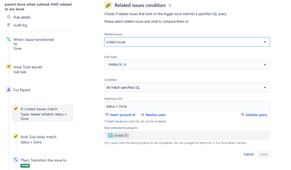

Stefan Salzl
May 3, 2022
mhm....got it.
Within the branch (where you change context of the automation rule to the issue that should be closed) add a condition that checks if there are other linked issues with status "not closed" (like the other rule is checking for other open subtasks).
Could look like similar to following:
