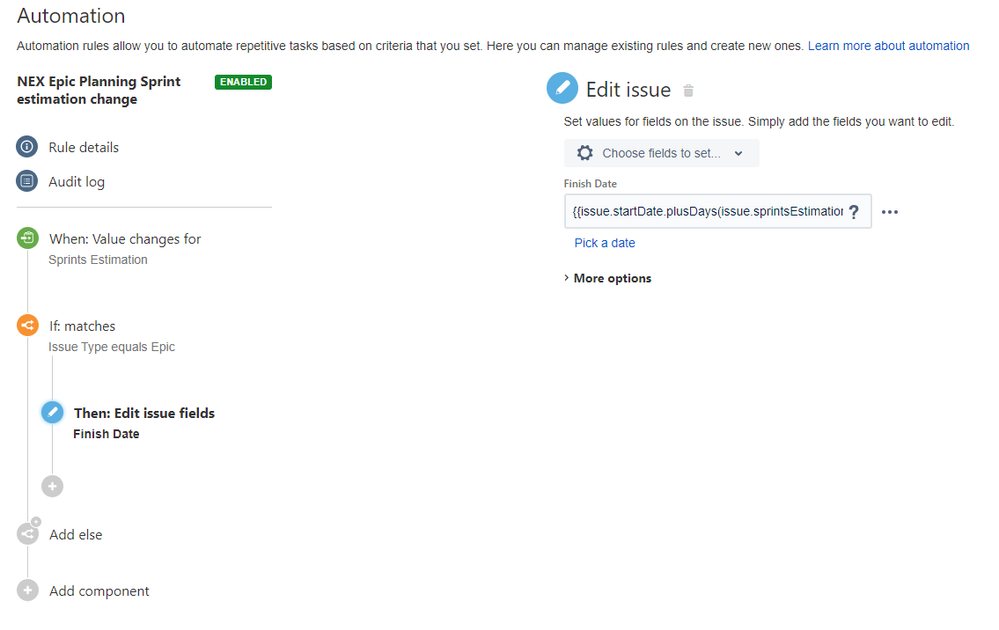

Hi @Lior Efraim can you show us the details of the part of the rule where you set the Finish Date value? Thanks!
LGTM. @Lior Efraim
