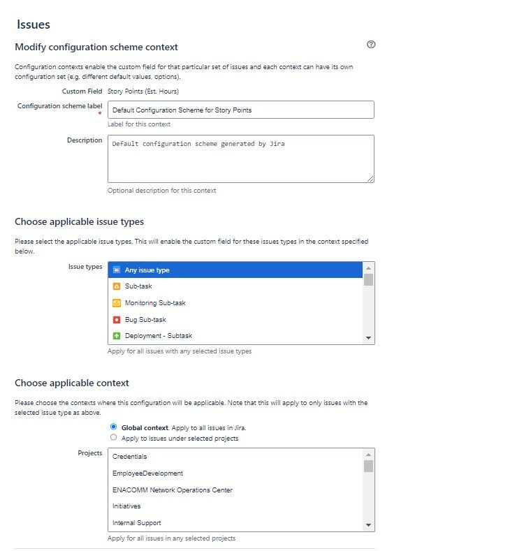

I have a field that I am using in global automation to fill in the value. But error log suggests this field is not available for my project type. However, the issue type shows available for all issue types and available globally for all projects. I am able to use it in an import for project type but automation doesnt like it.storypointserror.jpgstorypointsissuetype.jpg

Since it works from Import i assume it is on your create screen for that project and the task issue type but here are a few aspects to double confirm.
  1. The field Story points (Est. Hours)  is present on the task issue type create screen
  2. If it's not present
    1. Ensure it's added to the Create screen
    2. Ensure it's not marked as hidden in the field config
  3. Confirm you don't have two fields with the same name in the system
    1. If you do, confirm you have selected the right field in the automation  (customfield_10014)
If all the above is confirmed, try to set the field through the additional field section.  First, remove it from the "Choose fields to set" area to avoid any conflicts.
