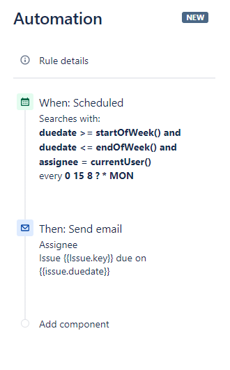

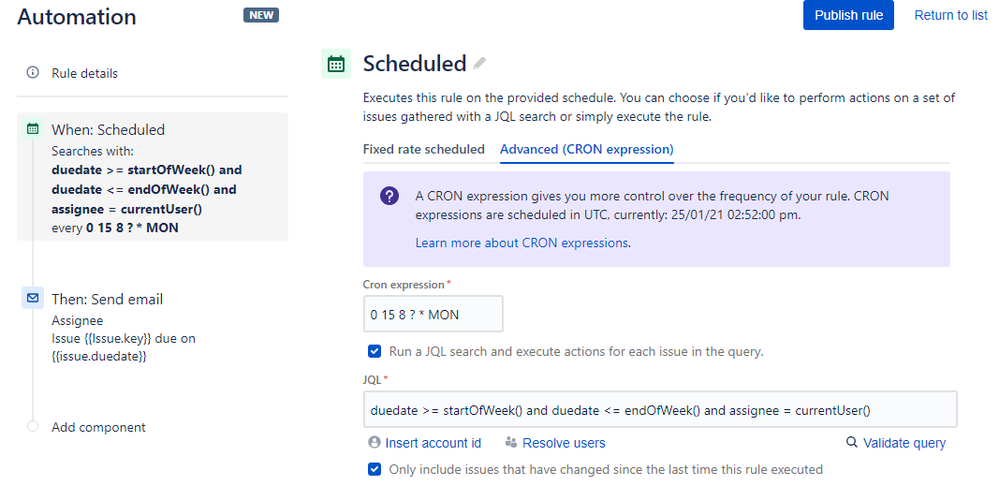

KAGITHALA BABU ANVESH
January 25, 2021 edited
Please try this once.
Every Monday 8.15 AM. assignee will notified with Due Date.
Cron+ JQL
image.png New Action
Hey sorry , I thought it's for a week.
Thanks.
Tom Williams
January 25, 2021
This works but sends an individual email for each issue returned in the JQL. My solution below returns a list that could be sent in a single email.
Like 3 people like this
