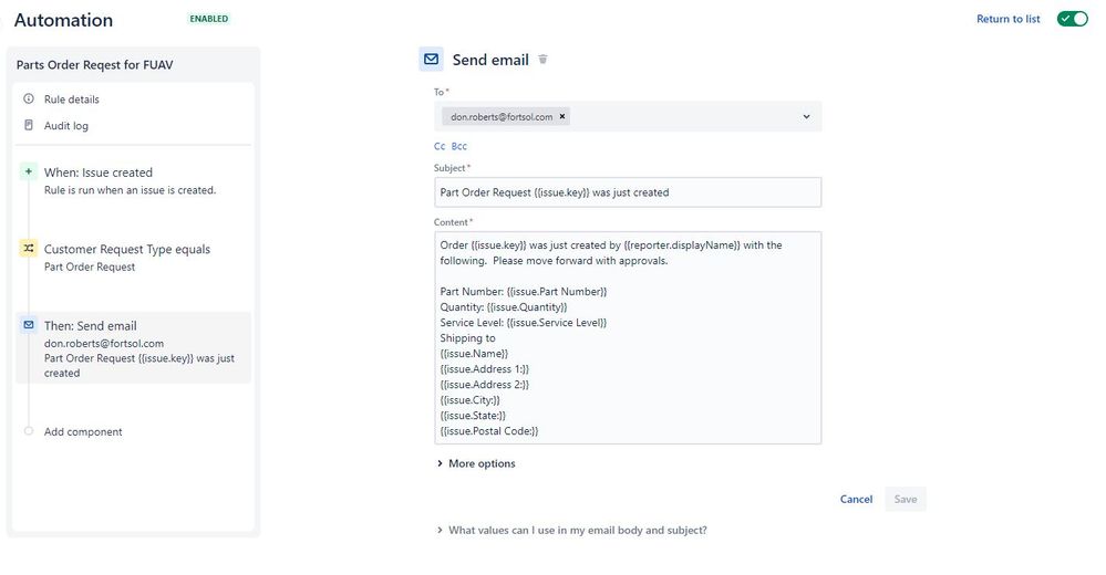

Hello Tobias.   When running thru the steps you show above i'm not seeing the component of "Request Type" equals.   See screenshot.   We are set up on a cloud based Atlassian environment.   I do not see an option to add a component.

Don Roberts February 16, 2023
Hi Tobias,
This may sound crazy but i'm totally confused on why i'm not getting the results i thought i would when trying to add information to the body of the sending email.  Screenshots are below. As you can see I have all the issu parts set up in the Content section with issue field names but the only data that is coming out right is the "Part Number"   Can you tell me what i might be doing wrong?AutomationScreen.jpg FormsBuildScreen.jpg EmailResultScreen.jpg

I'm not super knowledgable regarding custom smart values, but my initial thought is that it would need to have some addtional property after the custom fields name. Then again, the part number was visible with nothing extra 🤔
I would try to add .value after the CF names, like {{issue.Adress1.value}}.
That should make sure to display the filled in info for the field.
Let me know if that works 🤞
Darn.  I was hoping that was the fix but adding .value did not fix it.   I'll keep digging around to see if i find anything.  Its totally mind-boggling.  :-(
