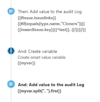

My proposal was, Before your branch, first please try to log below smart value, should pull the list of keys.. modify the if condition accordingly.
{{#issue.issuelinks}}{{#if(equals(type.name,"Cloners"))}}{{inwardIssue.key}}{{^last}}, {{/}}{{/}}{{/}}
You then convert this into a list by first storing above smart value into a variable (myvar) and doing a split. {{myvar.split(", ")}}, now you have a list of keys.
If you want to loop through and make a web request call for each of "parent" /original cloned link, I believe you can do an "advanced branch" afterwards on  {{myvar.split(", ")}} and make your web request calls for each "key" that way. Something along the lines of below thread or similar posts which loop over a list.

@Jamshaid  Sure, Just edited my post with screenshot, please check and let me know

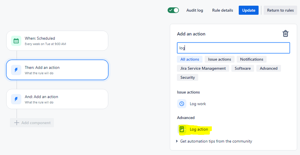

@Kalyan Sattaluri I can't find Add value to Audit Log in then: Add an action
Kalyan Sattaluri
February 13, 2024
In cloud, its called "Log action", please verify.

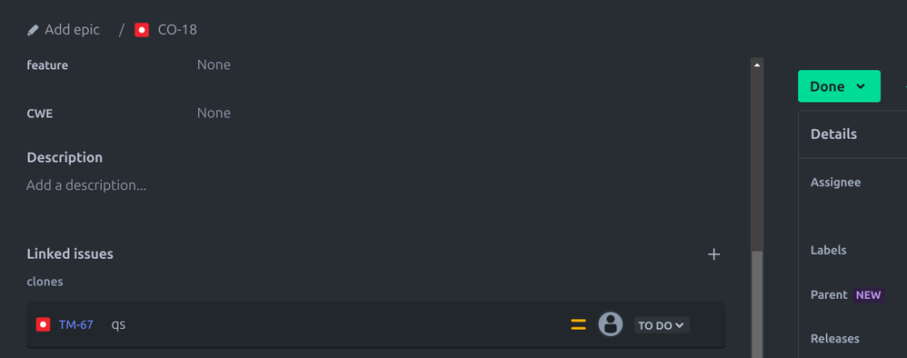

@Kalyan Sattaluri
Here is what appears in logs. It does not print anything from issue
Here is my rule
Here is the issue CO18
Kalyan Sattaluri
February 13, 2024
Your log below has TM-63 and your screenshot has TM-67.
