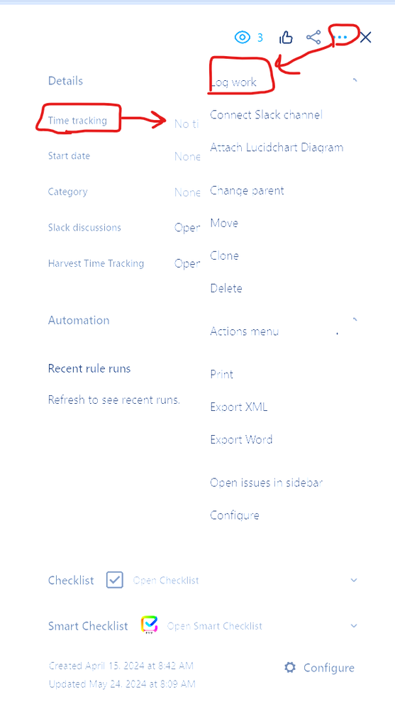

When using the "Log action" is this action supposed to be able to change fields within the issue? In this specific case my intent is to have the "Time tracking" populated with the total hours from creation to closure. Similar to when you manually log work in the issue by clicking the three dots then log work and entering "5h" for example.

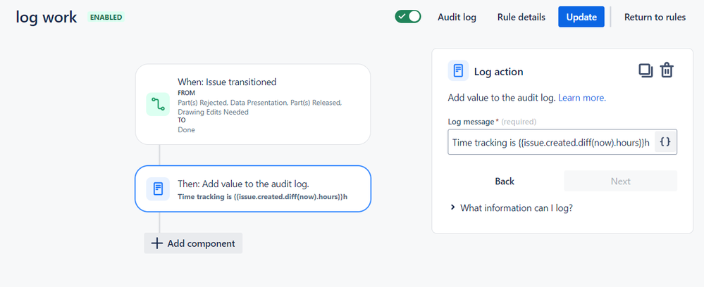

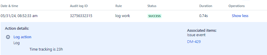

Anthony Amirfar
May 31, 2024
I'm getting a positive value in the log but no update is being made to the ticket itself. Is this action designed to simply return a value in the log and not actually change the "time tracking" field in the ticket as I am intending?
Thanks again for your help!
May 31, 2024
Ah, you also need to Log Work after that write to the audit log :^)
Please re-add your Log Work action, with the smart value:
{{issue.created.diff(now).hours}}h
Writing to the audit log helps to diagnose rule problems / see progress, but does not update any issues.
Like • Anthony Amirfar likes this
