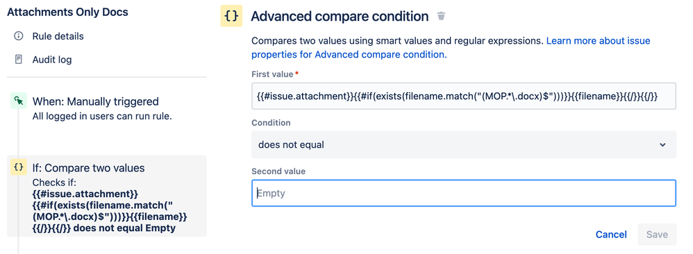

HOWEVER your rule will not work as intended unless you add a wildcard (.*) to your match, so it should be:
match("(MOP.*\.docx)")
Also, as with my advice to @E Hanumanthu you probably want to do a check to ensure that there is an attachment that matches what you expect before sending the email.

Hi. I think you may not have fully understood my instructions.
It looks like what you included in the email are supposed to be intermediary variables that are later used within the email.
So you need to use the Create variable action to create the variables I mentioned, like so:
Then you will reference those variables in the email, like so:
If you have additional issues, please share a screenshot of your rule.
