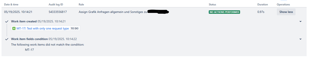

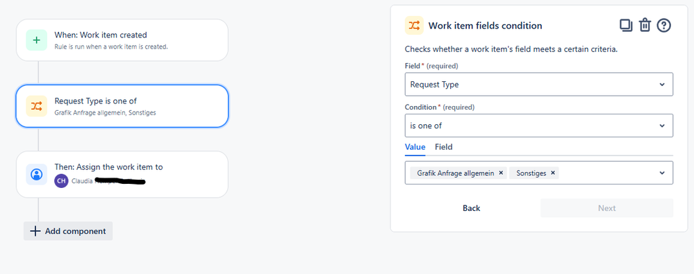

Hi, I do have a team managed Jira Service Management project and wanted to make an automation rule which assigns a created work item to a specific user, based on the request type.
But the rule is not run successfully, I always receive the info that "the work item did not match the condition"

claudia.hempel-delibasic May 19, 2025
Hi @Julia Watson-Clarke , thanks for your reply! I created the automation directly in my Jira service Manamgent project "Marketing TEST". For the creation of the project I used the template Service Management - Marketing service management.
Hi @Valerie Knapp , thanks for your answer.
I updated the rule and only added one request type:
But I received the same error message in the audit log:
And then I tried to remove the condition regarding the request type, and then the automation did work and automatically assigned the ticket.
So it seems that it really has something to do with the request type, but I don't know what is wrong there?
