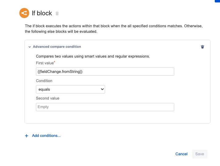

The below automation rule can help here to achieve this on Jira server/datacenter version without using any authentication method.
{{fieldChange.fromString}}
{{#=}}{{issue.Story Points}} + {{fieldChange.toString}}{{/}}
{{#=}}{{issue.Story Points}} + {{fieldChange.toString}} - {{fieldChange.fromString}}{{/}}
