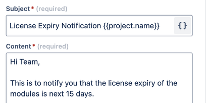

Anil kumar Matta May 29, 2024
Hi @Alex Koxaras _Relational_  I am using the {{project.name}}  in the email Subject, But when i receive an email there is no project name only the prefix text i have given is been displayed. Please suggest.
