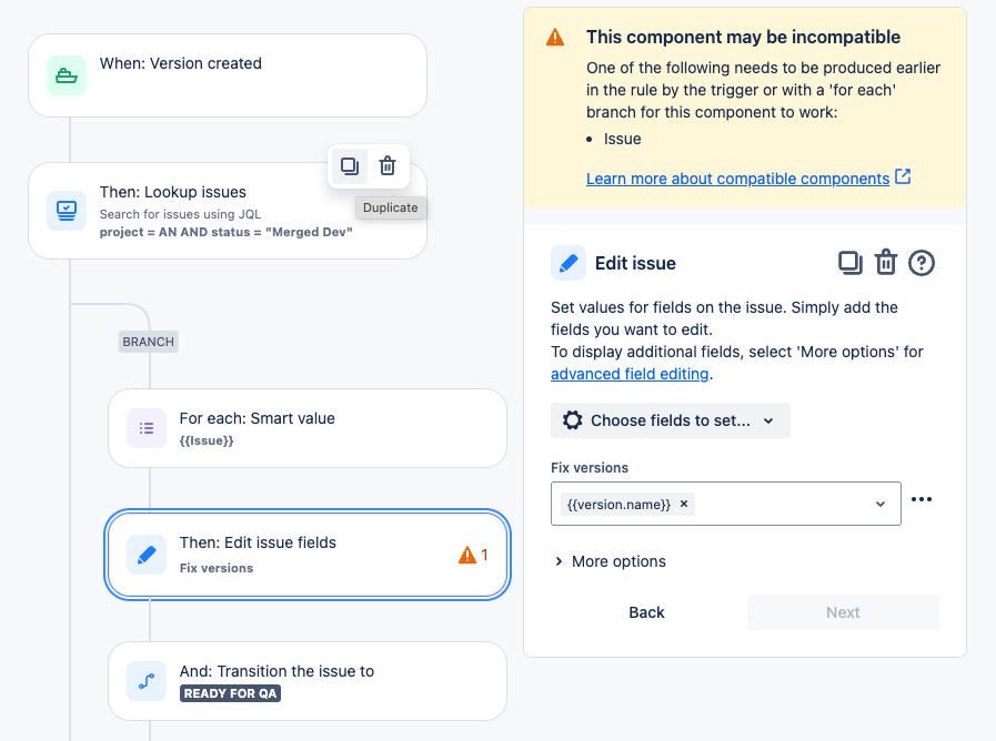

If I follow that with a For Each branch step the obvious thing is that I want to loop over the issues I just looked up and perform an action on each of them.
But so far I can't work out how to do this and neither the interface nor the docs give any help.

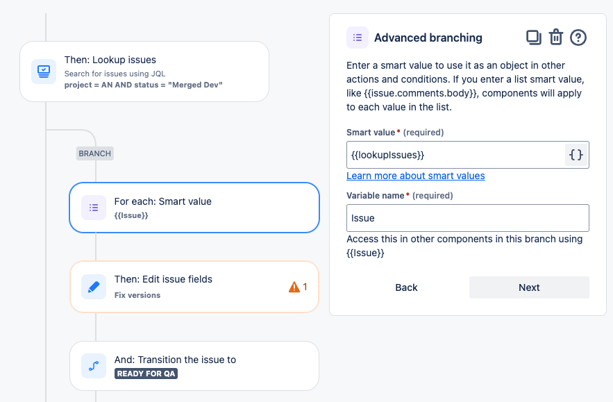

I tried an "Advanced branching" step with {{lookupIssues}} as the "Smart value".
But when I try to save my automation I get an error:
This component may be incompatible
One of the following needs to be produced earlier in the rule by the trigger or with a 'for each' branch for this component to work:
  • Issue
In the "Advanced branching" step I had set the "Variable name" to "Issue"... so I don't know what is the problem here.

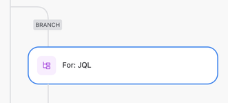

The lookup issues can only be used as part of a list, you cannot use it in a For each loop. Instead you should use the JQL branch instead if you need to iterate over the returned result.

The Lookup Issues action is the bulk-handling feature for work items selected by a JQL expression.  Its purpose is to sum / average / etc. values or to support bulk output, such as in a message or email.  The lookup results contain work item data, and so cannot be used with the work item actions, such as Edit Issue Fields, as they expect work item objects
To individually process a list of work items meeting some JQL criteria, either use the Scheduled trigger with JQL or a Branch on related items with JQL.  The one undocumented feature of the second type (Branch on JQL) is when the rule trigger provides an issue, that will be automatically excluded by the branch to prevent an endless loop / runway rule triggering.

Thanks, the validator let me save it with that change so it seems to have worked.
