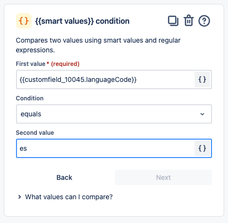

So then it looks like we'll have to use a Smart Values Condition.
I had to do the following:
  • Find the "Request Language" custom field's ID on my instance.
  • Once I had that in hand, I needed to see what that Smart Value looks like, so I used the Log action to see what {{customfield_10045}} (AGAIN I believe this is specific to my instance - you have to follow the instructions above to find your instances own ID for the field) returns, which was this:
    • {languageCode=es, displayName=Spanish}
So then, putting it all together, you can create a Smart Values Condition that looks like this:
Or this:
Again, that customfield ID is UNIQUE TO MY INSTANCE (I think).
