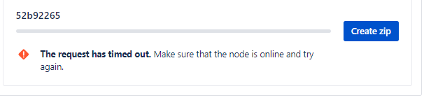

Sorry I couldn't provide a support zip with the logs & config because the node does not stay connected long enough to download it.Screenshot 2024-10-14 105700.png
