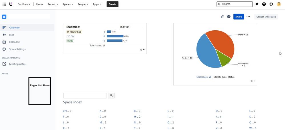

while using Confluence cloud; I am stuck with the issue where pages in confluence space stop showing.
To over come this I have to open a recent document from space then it will again started showing all the pages.
Steps to Reproduce :
Step – 1 -->  Open a Space; Pages in the space not Shown
Step – 2 --> Open Recent Document from the same Space
Step – 3 --> After Opening recent Document, Pages started showing

I was just able to replicate the problem you had, and my page tree looked like this originally:
The Test Project page is my default homepage (aka Overview page), and whenever that was set, my pages wouldn't load. If I set my homepage to be another page, it started working again.
To fix it, I dragged my Test Project (Overview page) to the top, and then made sure everything was under that, and now it looks like this:
This is how the page tree should have looked by default, when I compare with my other spaces, so I think that somehow the pages were orphaned anyway and was causing this behavior.
