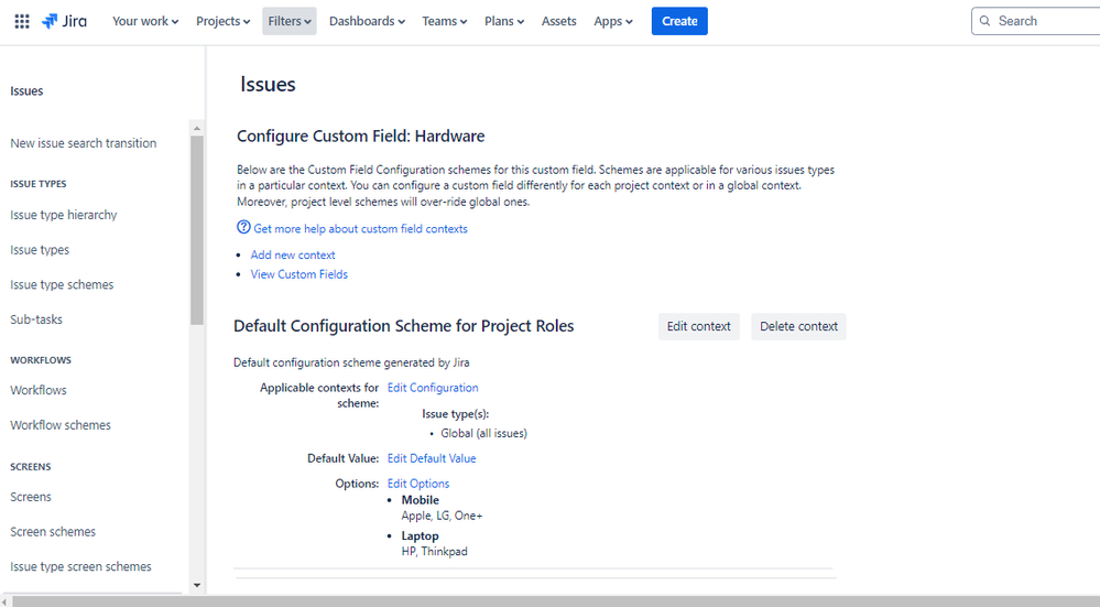

I'm a little confused, my Project custom field already has this.
What are my next steps?  What am I missing?  I still cannot access 'Project' on a from to link to.
Is it because, currently, the 'Project' custom field is a cascading drop-down and instead it should be a standard drop-down?
So, I need to recreate it and delete the cascading drop-down, is that correct?

Vijay Dadi
May 13, 2024
@Ian Walker ,
Hopefully, my screenshot below answers your question. Cascading field can't be linked to a field on dynamic form, instead use it as a normal jira field.
PS: Don't use the cascading field on the dynamic forms.

Richard Scholtes
May 14, 2024 edited
@Ian Walker
yes. To circumvent the fact, that cascading drop downs are not (yet) possible in forms you will have to create at least two normal drop downs out of it and maybe work with conditional sections in the form to get the information from the form field linked to issue fields
Like Ian Walker likes this
