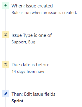

Tracy Powell April 18, 2022
I've worked around this with a bit of a "hack". I'm just checking if the due date is within the next 14 days, and if so, moving the issue to the active sprint. It's not ideal, but it will be a bit more help than nothing.
Hey, Jenn. I'd love this as well. Perhaps at a minimum you could use the "Next sprint" option?
I've created a bit of a hack for my use case that kind of works. I'll post it as a separate answer here.
Hey, Sadeesh. Yes, I understand this is a bit of a mix of scrum and kanban. It doesn't make sense for my team to work off 2 boards (one scrum and one kanban) and we are currently using scrum. The items that I need to move into the current sprint are support tickets - so either bugs or customer requests unrelated to feature development. These are time sensitive, so we need to scope change by adding them to the sprint. They are typically in the 1 story point range or less.
I don't understand how you are suggesting I would do this within Jira automation:
Yes its possible by filtering the issue which needs to be added to active sprint and change the respective issues Sprint value to active sprint value.
Could you share more specific details please?
