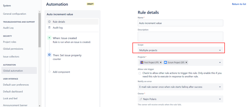

Hi @Gail
If you are the Jira admin you can create global automation and select the scope for multiple projects as necessary without having it run through all projects.
