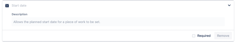

there are multiple start date selections (see screenshot) is there one that i should select in particular? i would like it automate the field that cannot be removed from a task. (i.e screenshot attached)Screen Shot 2023-02-09 at 6.15.29 PM.pngScreen Shot 2023-02-09 at 6.13.57 PM.png
Mikael Sandberg
February 10, 2023
The one that is called Start date is the one that is the default one that Jira creates, all the other ones are custom fields. Without knowing your instance I cannot advice you on which one to use.
