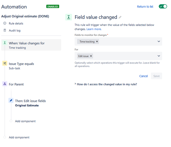

I have a simple Automation for a Sub-tasks:
If someone created a sub-task and sets there an 'Original Estimate', then this value is subtracted from Parent's 'Original Estimate'
Edit issue field have formula:
{{#=}}({{issue.fields.timetracking.originalEstimateSeconds}} - {{triggerIssue.timetracking.originalEstimateSeconds}}) / 60 {{/}}
And here is the screen of the rule:

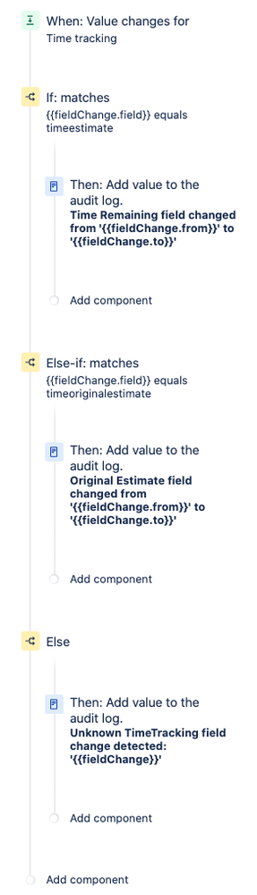

It took some digging in the docs and experimentation, but I created the following test rule. The conditionals and smart value usage should help you with what you need to do.
This rule uses the same trigger you're using. The conditionals differentiate which field changed (and also detects an unexpected trigger). The logs illustrate how to access the "before" and "after" values for each change.
Note that the numeric values are accessed in this rule (e.g. fieldChange.from). If you want string versions, use fieldChange.fromString instead.
Note also the conditionals ARE CASE SENSITIVE. So checking for "timeEstimate" will NOT work -- the first conditional shown here uses "timeestimate".
Hope this helps!

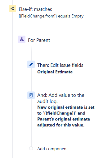

Alexey
January 14, 2021
Small Update, ELSE need some adjustments otherwise it will keep editing Parent's original estimate every time you change Sub's remaining estimate or wont reserve budget on a first Sub's estimation.
