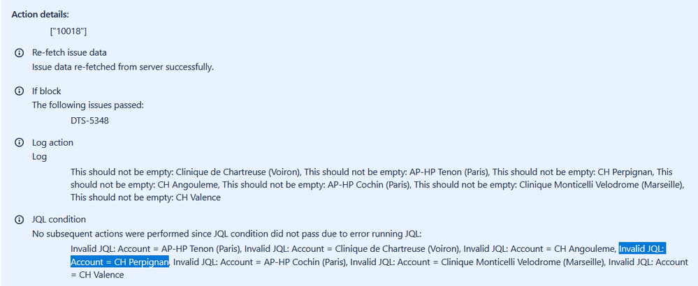

Estelle Decanis
December 21, 2023
I change the condition :
The center of the trigger issue is identical to that of an existing ticket (this is what I was looking for) :
But it's still marked Invalid JQL :/

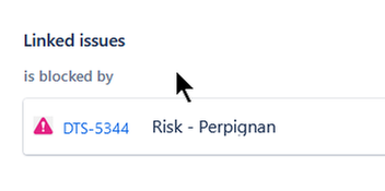

the action could be done (= link issues) :
Here's the automation :

December 21, 2023
Well done!
And I see why your JQL condition failed: there are embedded spaces (and other characters) in the values.  The fix for that would be to wrap the smart value in quotation marks for the JQL, like this:
Account = "{{issue.customfield_10044.value}}"
