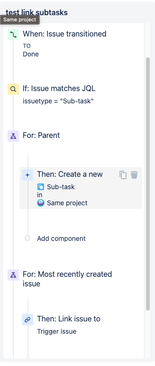

OK I think you failed to do it because there is no direct link between these two sub-tasks (you need to pass by the parent).
A solution, if you get only these two issues in your parent task, is to create your both subtasks in the same rule, to link the first created to the other with the "most recently created issue".
With a rule like that.
I hope this answers to your problem :)

With this rule, you will link all subtasks to the new one.
You can do what @Bill Sheboy said if you want to be more specific. In this case don't forget to add "Linked Issue" to the create screen.

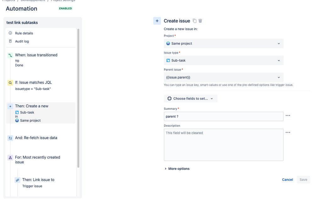

Else if you don't want add "Linked issue" to the create screen, you can do that :

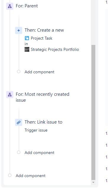

Thanks, JM. I tried to mimic what you have above and got this error.
JM,
Thank you so much! I got it to work successfully. It worked by removing the branch and using a smart value instead. Thanks again!

Without seeing your rule, I suspect the challenge is the order of branching and linking. Perhaps something like this would help:
