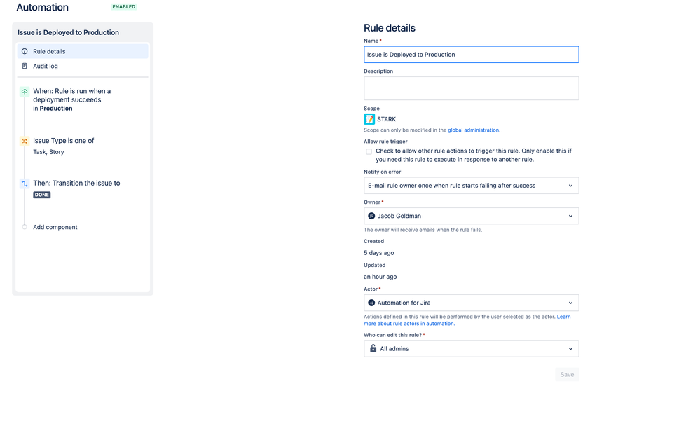

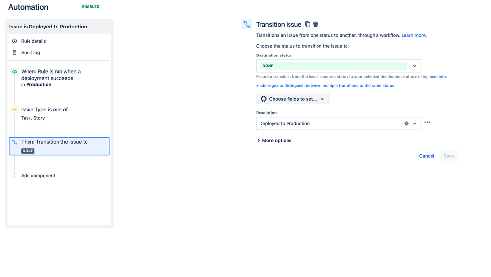

I am trying to create an automation rule that, when a story/task is deployed to production, sets the status to done and the resolution to "deployed to production.
Our Workflow:
STORY/TASK: TO DO --> IN PROGRESS --> IN TESTING --> VERIFIED --> DONE
The ticket moves successfully through our workflow through the triggers in the workflow.

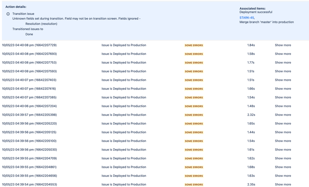

But when it gets set to DONE, it is not setting the resolution, and I get the error of "Unknown fields set during transition. Field may not be on the transition screen. Fields ignored - Resolution (resolution)"

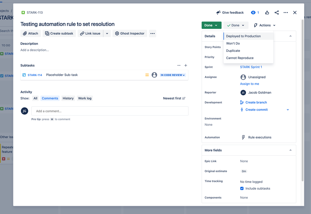

But as you can see from the screenshot, I can manually set the resolution to "Deployed to Production."

Try to associate a resolution screen (a screen with the resolution field) to the Done transition and it should resolve the issue.

@Karim ABO HASHISH  - I've tried! I am using a slightly modified version of the default scrum ticket with the resolution field added. And this screen is associated to the final transition. I tried this to see if it would work. I don't like having the same screen for every state,Screenshot 2023-05-10 at 10.40.24 PM.png Screenshot 2023-05-10 at 10.46.14 PM.png but I am trying to remove variables.

Simply create a new screen with one field (Resolution) and add it to the transition.
Let me know how it went for you

@Karim ABO HASHISH - but the resolution field is there already. Why is another screen needed?

  • The "Resolution" field is an important feature in Jira. It specifies the reason an issue is closed and removes the need of having multiple statuses with the purpose of stating why the issue is closed,
  • Ideally and in common implementations, there are 3 Standard screens for Create/View/Edit operations within your project.
  • As a best practice, Resolution field should not be added to the project standard screens (except for view screen). why? as There are many native functionalities in Jira that depend on the "Resolution" field.
  • Keeping the "Resolution" field working according to the best practices is crucial for your team to leverage Jira on exploring your company's potential.
  • The best practice in your case is to create a new screen with the resolution field on it, then map this screen to the transition to the "Done" status. You should also remove the resolution field from your project create and edit screens.
