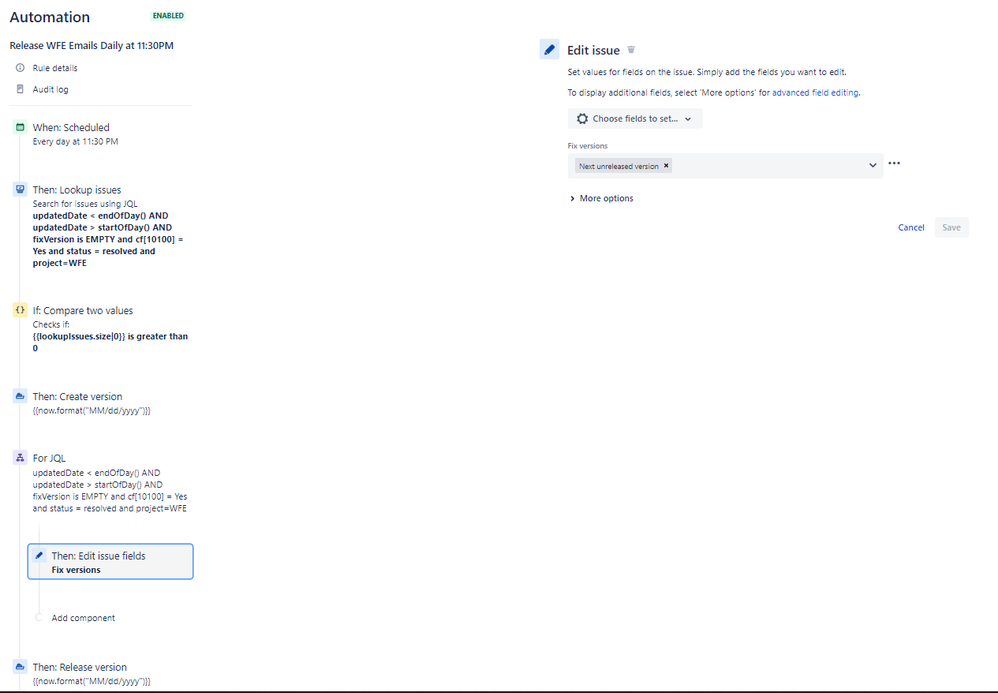

Hey I have a automated job that runs every night at 11:30 PM that basically checks in the project if any tickets were marked as resolved for that day and if so it creates a version, edits the fix version for those tickets and then releases the version.

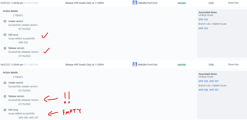

This works great if only 1 ticket was released but if 2 or more are released the release is empty
here is the rule:
The JQL selection is the same in both cases
so what I would expect is that the for each loop would suspend the automation until its done looping through
can anyone provide me some help?

Hi @Kevin McGillicuddy
Too long; didn't read: this is a timing problem, which is solvable.
Branches which can occur on one-and-only-one issue (e.g. branch on parent) get run "in-line" and so the rule proceeds after the branch.  But...all other branches execute in parallel and asynchronously: there is no guarantee they will even finish before all other actions in the rule.
So for a work-around you need to capture the Created Version information so it is not released before you try to reference it as the "next unreleased version".
A few ways to try that are:
  • Complicated, slow, and will always work: REST API
    • call the REST API to get the version you just created, and
    • use that value in the branch to edit the issues
  • Simple, and will always work: dummy issue
    • create a dummy issue in the rule,
    • branch to Most Recently Created Issue to assign the next unreleased version,
    • save the {{createdIssue.fixVersion}} in a created variable
    • reference the created variable in your original branch to set the version, and
    • then delete the dummy issue at the end of the rule
  • Simple, and will probably work: update one and reuse
    • similar to the dummy issue technique, branch to the first issue found in the lookup and edit that one, exit that branch and re-branch to it again, and then grab the version to save in a created variable
    • then in your original branch there will be one fewer issue to process, and you can use the created variable for the update
    • Please note: this may also run into a timing problem if the second branch starts before the first one finishes.  Yikes!
