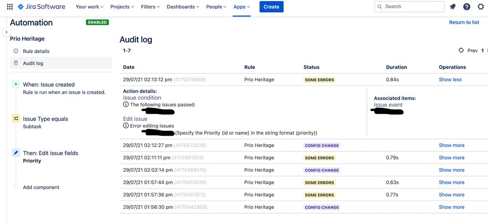

I created a rule to heritage Priority Levels of User Story's to related sub-tasks. It failed and I dont understood why. Please find the details below, fail log and rule itself.Ekran Resmi 2021-07-29 14.32.48.png

when i run, an error occurs in there. i did exactly same steps but there is an error, which i posted in the main question. i actually dont understand why.

an error occured in mine. i did same things (you may see in main question) but couldnt success

Then; to understand the reason of problem, i changed my case. I created a rule with same way, but not use priority that time, i used assignee. When i ran that rule, it seems succeed in activity logs, but it not heritaged actually. I wish i have a screen sharing call with you.
