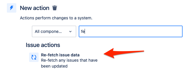

Not totally sure if this helps but have you tried to re-fetch data in your Automation rule to make sure the newest data is available to the rule?

Well, I hadn't looked at the Re-Fetch action so thank you for pointing me to that!
It did the job though does slow things down but can live with that. I'm now scratching my head trying workout how Jira has implemented this because that wouldn't have been the obvious solution to me :). It seems more analogous to a sync on Unix/Linux and if they'd used that name I might have found it myself.
So, for posterity, here's how I solved it. I first cleared the Stakeholders. Then I have several of these If:matches that all follow the pattern below.
In the Edit issue I used the "Copy from issue" (I removed the names that would be added after that for privacy). Without the Re-fetch action it would just use whatever names were in the issue when the automation was triggered.
