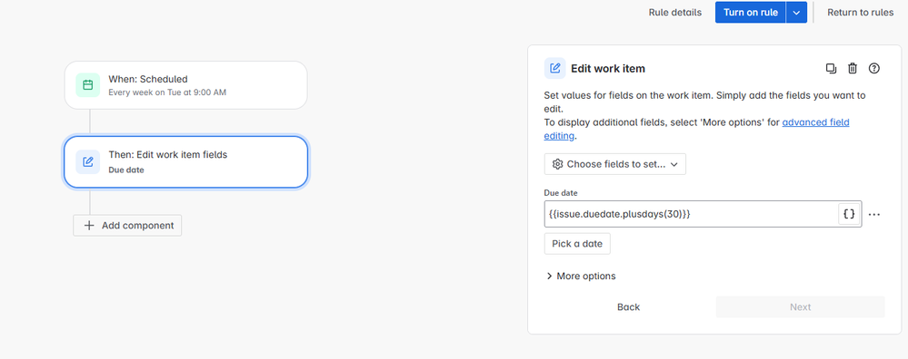

I think i found a working solution for you:
  1.  Create a trigger "When: Scheduled"  set End date to "One occurence" and add a JQL i.e.  "project = XXX and duedate is not empty" so you filter out the issues you want to update.
  2. Add a FOR EACH branch and select "Current work item"
  3. Add a THEN step and choose to update the field "Due date" and paste your smart value {{issue.duedate.plusdays(30)}}
  4. Set the date and time for when the trigger should fire and update the rule
I would recommend to test the rule for a small number of issues first and validate the functionality (narrow down the JQL to only include a few issues).
The rule would look something like this:
Let me know if it helps!

Ian Rickwood June 24, 2025
Hi Staffan,
It works when I put {{project.Test}} as the statement in the trigger for the rule but the branching you gave me helped a lot, thank you.
I am able to shift my projects out as desired, thanks again to the community.
