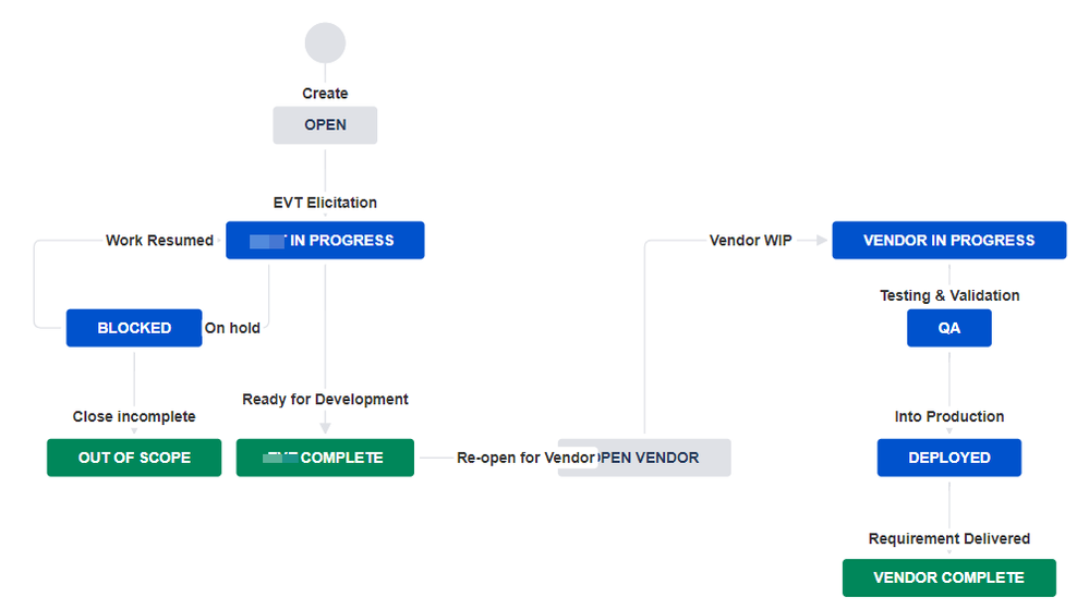

The Solution I came up with was to have an almost branching workflow with applied post functions to clear the Sprint, Resolution and Status before going to the second stage/sprint. I have a sprint for the same workflow run through two boards. An issue can still run through a sprint and return to the backlog, if it is not completed. Once I close the sprint, I can then move Stage 1 'done' issue to the next backlog so it can be pulled into a stage 2 sprint/s. It took quite a lot of redesign and testing but it seems to do what I need. Maybe others will find this approach works for them.

Hi @Scott Windus
I believe this method will prevent the first team from seeing any useful measures in JIRA for their work: velocity, sprint report, etc..  Scrum teams often use such measures as indicators of areas where they could improve.
That is the reason I was suggesting there are two work items, one for each team.  Then the work can flow and complete independently.
