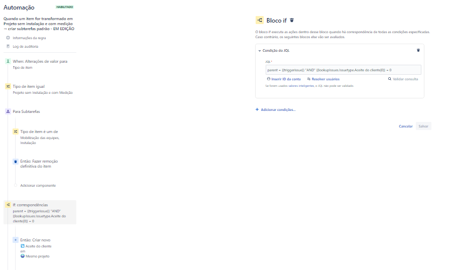

I am trying to use the JQL search, but i am doing something wrong, i used this rule.
you could help me with this rule?

Hi, Douglas!  A few things I noted in your rule images:
1) In your condition you are testing Lookup Issues information, but you have not used the Lookup Issues action.  That needs to happen first to load up the data with a JQL statement to look for any missing sub-tasks.
2) In your condition JQL, there are a few issues:
  • you compare to the entire trigger issue rather than the key: parent = {{triggerIssue.key}}
  • it appears to have some stray quotation marks around AND
  • JQL is not a SQL, and so you cannot include lookup issues on the left side of an expression
Like Douglas Oliveira likes this

But doesnt worked, I belive that have something wrong in my smart value, I am use:
{{lookupIssues.issueType.Aceite do cliente.size|0}} = 0
Is the correct way ?
Douglas
October 26, 2021
Douglas, you cannot query with lookup issues that way.
