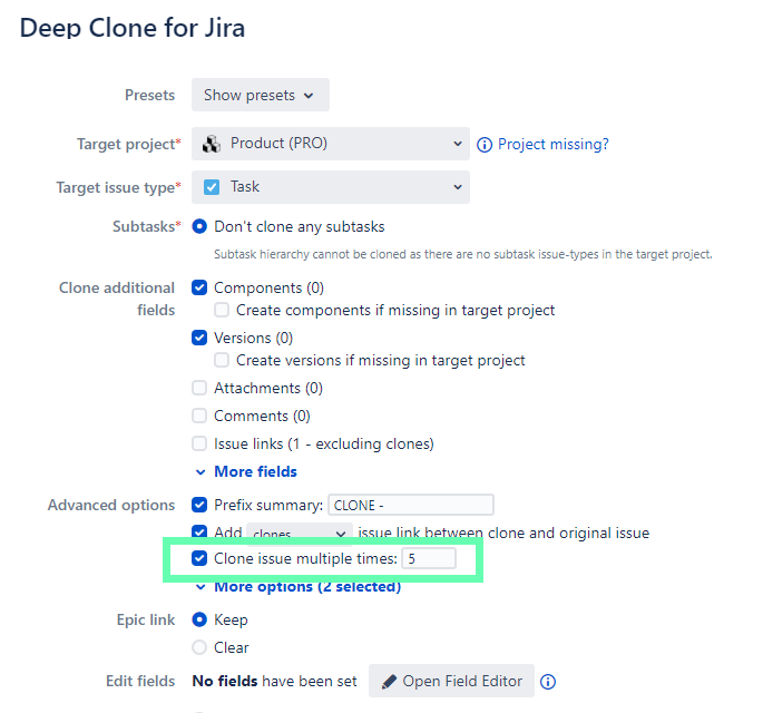

Marlene Kegel - codefortynine
March 10, 2022 edited
Hi @Harry Klein,
I am Marlene from codefortynine.
It should be possible to integrate your use case with Subtasks as described by @Trudy Claspill
If that doesn't work for you, you can also check out our app Deep Clone for Jira.
With Deep Clone you can clone single issues multiple times. The process is pretty simple and can be done by any Jira user.
After you've installed Deep Clone to your instance, you simply:
  •  Navigate to the issue you want to clone multiple times
  • Click on the three dots menu on the top right
  • Click Deep Clone
  • Configure your clone (including check "clone issue multiple" times under the advanced options)
After you've cloned the issue multiple times, you can assign the clones to the corresponding people.
