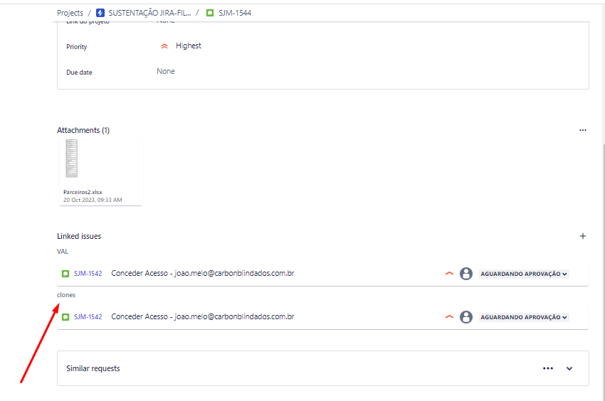

So that's right, I'm making a Pos Function where a condition exists:
Trigger: When an Item is linked.
Pos function: Add a label
Condition: When the link type is: VAL
In that case, you're trying to test the link type of the issue link being added, not of any existing issue link. The link being added is available through the context.issueLink variable, as documented on the event based actions documentation. However, only the issue link type is available, not the issue link direction. For example, the "Clones" issue link type has two issue link directions: "clones" and "is cloned by". And users select a link direction, not a link type, in the "link issue" dialog box. So you'll need to figure out what the link type name is on the "Issue Linking" Jira admin page. Then you'll be able to use a condition like:
{{ context.issueLink.issueLinkType.name == "Clones" }}

Unfortunately, you cannot "test" the condition in the post function editor, as the context is empty (you are not currently linking an issue). You need to test it by saving the event based actions and linking issues together
Hello, I understand.
I'll test it here and get back to you soon.
I carried out the tests here and it was ok, you are a legend, thank you very much!
