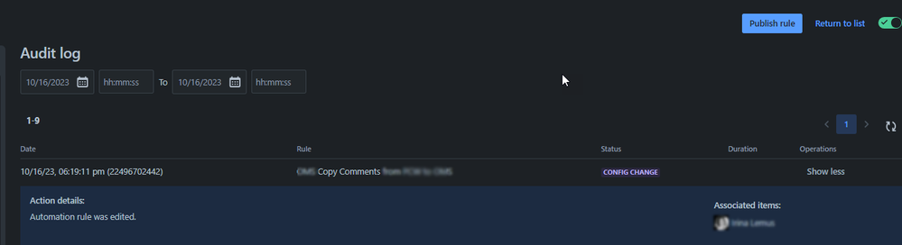

Can you provide the output shown in the Audit Log for the execution of the rule also?
Irina Lemus
October 16, 2023
Added both. Thanks again @Trudy Claspill !!
Trudy Claspill
October 16, 2023
In the Audit Log there will be two types of entries.
One type of entry is made when you change the rule and click the Publish button. Those entries show a status of "CONFIG CHANGE". That is the type of entry you've shown us.
The other type of entry is made when the rule executes. That type of entry will be made only if an event occurs that matches the Trigger and it happens in one of the projects specified on the rule's Rule Details page in the Projects field. The execution entries will have statuses like "Success", "Some errors", and "No Actions Performed".
Please show us the details of the most recent Audit Log entry that does not have a status of Config Change.
Also please confirm that the Rule Details page Projects field lists the same projects that you have in the second component of your rule.
Another thing to note is that when you use the Issue Commented trigger you can use the {{comment}} smart value to access the information for that newly entered comment. You don't need to access it through the triggerIssue smart value. You could instead use {{comment.body}}
Irina Lemus
October 17, 2023
@Trudy Claspill the rules details are not getting saved in the audit log, although the rule is getting executed. That's the point I tried to exaplin earlier. Is there any other way that  you know I could try to change this rule? Do you happen to have rules like this that work for you? If so, what are the parameters? The same or different?
