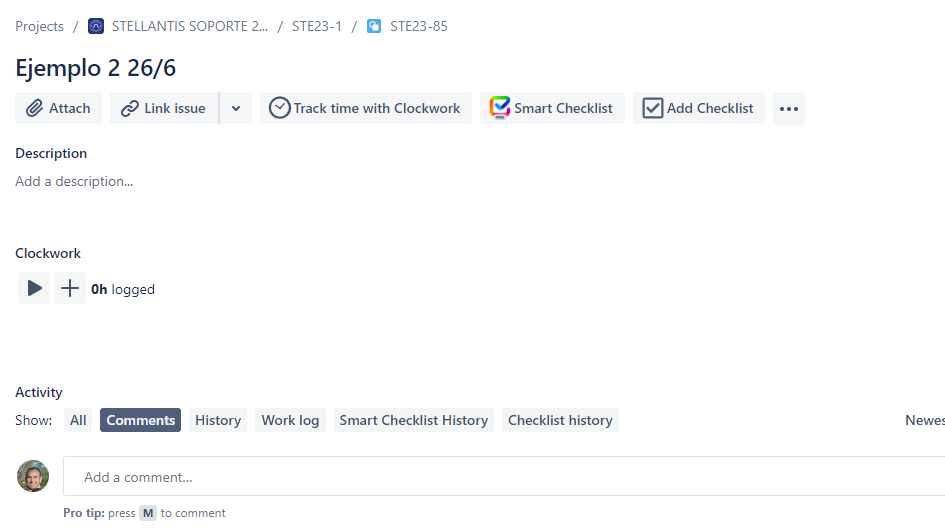

Jose Antonio Quesada June 26, 2023
Hi @Marco Brundel
It sound goods, but it doesn't work, I don't know why??
Audit log describes it works, but the linked issue is not in the issue:
But the parent task has a linked issue:
What is wrong?
Thanks in advance?
BR
Jose
Marco Brundel
June 26, 2023
Hi @Jose Antonio Quesada ,
Question: if you look in STE23-63, do you also not see STE23-85 as a linked issue?
Regards, Marco
Hi @Marco Brundel
No..
BR
Jose

Marco Brundel
June 27, 2023
I see you use 'copy linked issues from current issue'. If you change this to 'copy linked issues from parent issue' does it work?
regards, Marco
Like • Jose Antonio Quesada likes this
Jose Antonio Quesada June 28, 2023
Yes!!! It works!!!!
Thank you very much @Marco Brundel
