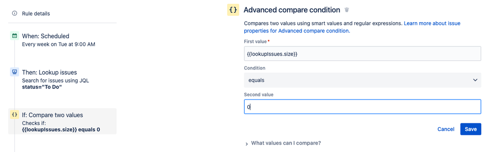

However, I would recommend a different way to accomplish this with Automation.
When you set up a Schedule trigger with a JQL statement, that is usually done because you want to execute some operation for all the issues that are found by that JQL statement.
Instead I would recommend that you use the Schedule trigger without a JQL statement.
For the next component I would recommend the Lookup Issues action. You can use a JQL statement to search for issues.
After the LookupIssues action I would add a Condition: Advanced Compare and check how many issues were returned by the Lookup Issues action. The value you want is the one that will indicate you DO want to proceed with creating a new issue. I would construct the JQL so that you would want it to return 0 issues.
And then add the Action to Create Issue.

Does the JQL in your Lookup Issues action represent the criteria you want to apply to figure out if an issue already exists? In my example I used "Status" in my criteria. In you latest images I see that you also used "Status", but in your original images you were using "PSA". You need to set the Lookup Issues JQL to use the correct criteria for your situation. If you want to only make an issue when there are no issues where
"PSA" equals <some value>
then the JQL in you Lookup Issues action needs to reflect that; i.e.
PSA = <some value>
If there are any issues where PSA equals <some value> then the size of the lookupIssues results will be greater than zero, and your rule will terminate on the condition where you are checking that size value.
